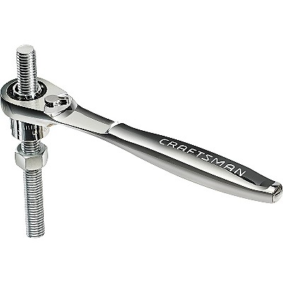

Very nice thread has tons of useful information! If I may add when I took my struts apart to do the Bilsteins, a set of Craftsman Max Axess wrenches will be your best friend. You can put the socket down over the shaft on to the nut and use a combination wrench (on the factory strut) and the allen key (on the Bilstein) to hold the shaft from spinning while you loosen/tighten it!
This is just a pic I found online using both wrenches that come with the bigger max axess kit (a smaller cheaper kit is available in black for about $40). The top of the shaft with the hex end is exposed from the wrench so you can use a regular combination wrench or crescent wrench as that is the way I did it

yes! that's what I tell everyone. those were my life saver
