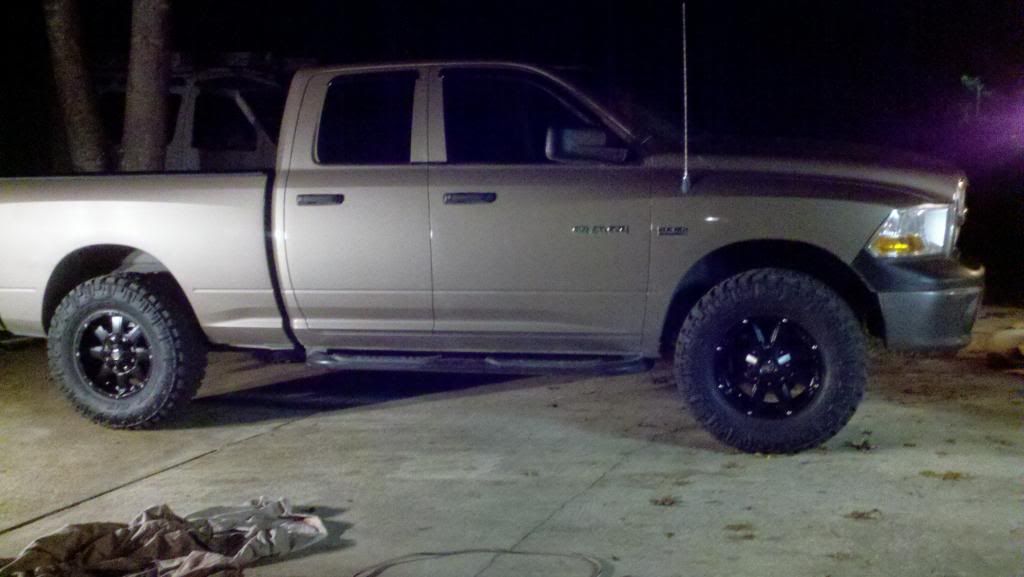

to help with what your looking for, here is a picture of my truck, leveled with 35x12.50x18s.[IMG][/IMG]
Westin black step bars, Diablo intune, 35x12.50x18 Nitto Trail Grapplers, 18x9 -12 offset MAYHEM CHAOS wheels. 2.5 inch dual exhaust with a custom made x-pipe before dual dynomax race bullets, topped off with rectangle tips.
