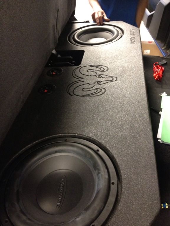

Sub stage :
Two Arc Audio Black 12dvc4
Fox Box Vented with custom vent plugs essentially making it a sealed box if I wish
Heavy sound deadener inside enclosure (helps a lot guys!) especially in plastic tubs
two Alpine MRP M-500's ran mono obviously
Each subwoofer wired parallel to a M-500 for 500 watts at a 2ohm load
I was very happy with this system and it would please 90% of folks.
Had great staging, good volume, crystal clear, decent dynamics, and a lot of fun factor with the substage being that it hit pretty darn good

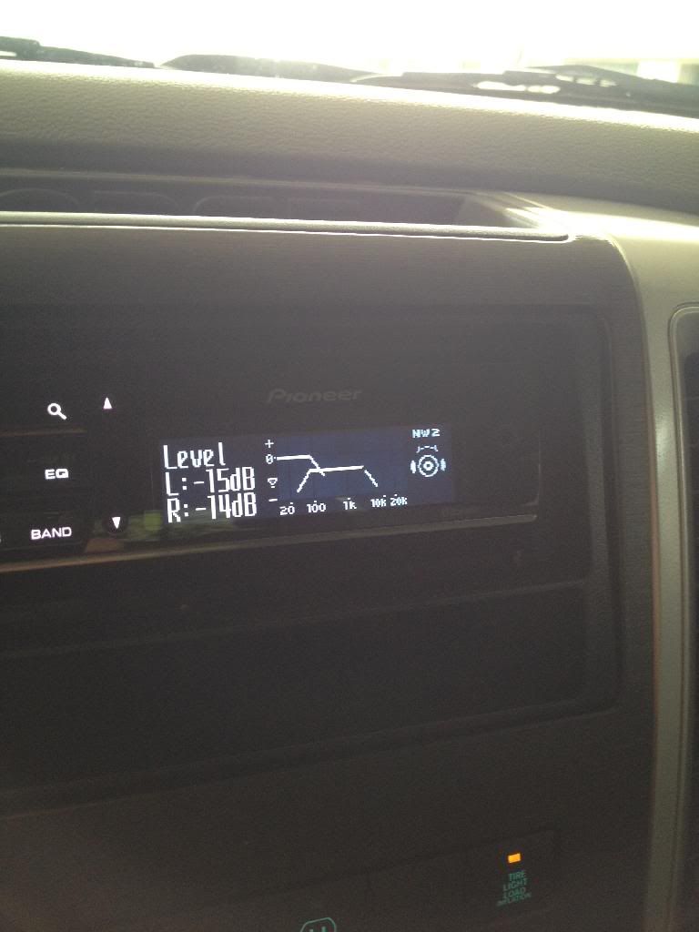

next phase was more power. The DYNAUDIO esotar 650's are efficient enough to sound beautifully with 90 watts but I knew more power would really make them come to life and add tons of dynamics to the music. So I decided to pull the DYNAUDIO md102's off my Arc Audio KS300.4 and bridge the amp essentially sending 350 watts to each esotar 650 and I was right. They came alive! Some added output...maybe 6db's or so, but tons of dynamics. The 650's became much more snappy, tons of attack, and have zero hint of falling apart at very high volume. They hold their composure very well.
So now I need a dedicated tweeter amp.
I had the opportunity to try an Arc Audio 2075SE which is a beautiful amp and dead silent. Pushing 75 watts to each md102 and they sounded really good. Some people believe that power is power and amps do not sound different, but this clearly showed that they do! The 2075SE made the md102's sound a bit better. More neutral, warm (if a tweeter can sound warm lol) and vibrant.
So now I have 2 subwoofer amps,
an amp for my midbass
and an amp for my tweeters.
The nice thing about the Pioneer 80PRS is it's ability to run active, have multiple crossover setting points (too many actually)
Time alignment etc...
but also have complete control on level matching every speaker in the system so one pair isn't over powering the others. That made matching my tweeter output to the midbass very easy, but I def messed with that for a few weeks.
when in doubt...get more power...your speakers will thank you
^^lot of people do not like the look of a single din HU these days, but the processing capabilities of this head unit at this price point is second to none...atleast when it comes to brand new, current HU's on the market
