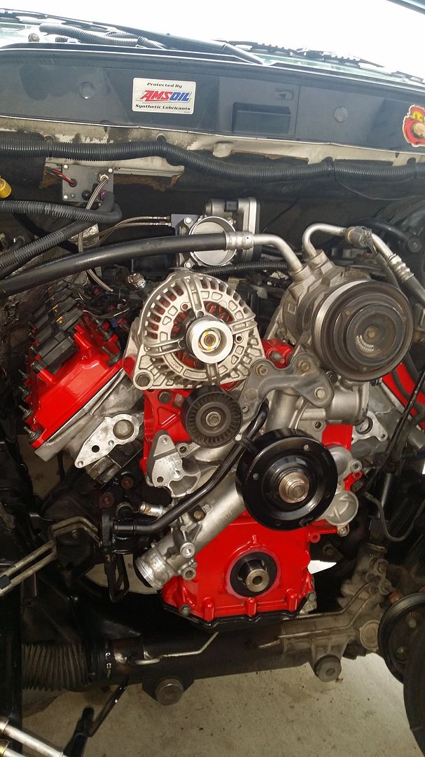

gettin closer..I can taste it..hehe

I'm about there gents...radiator and headers are all that's left. I just put breakin oil in tonight as well...

This looks freakin' awesome, Fred!
What kind of oil were/are you running that kept everything lookin' so clean?

I use Amsoil 0w-30 signature series..and get this, my oil change interval is once a year (25k miles)

What about filter type and frequency change?

I have an Amsoil oil bypass setup...I also change those filters once a year..

radiator and headers installed...just gotta install the new base tune and I'm ready to rock and roll... gona do first startup saturday afternoon
Just looked at that. When it's all said and done, that sucker is about $500 isn't it? Gotta by the unit for $280, then the 22x1.5mm adapter for $60 and then your first two filters for $40/each. Ugh. Gonna take some mulling over to figure if that's worth it or not. Plus some math to balance the cost of quality synthetic oil change every 5k vs. that thing.

the initial investment is expensive (I don't remember how much i paid) but after that it's all good for a superior oil... I've run this setup almost 10 years now..
