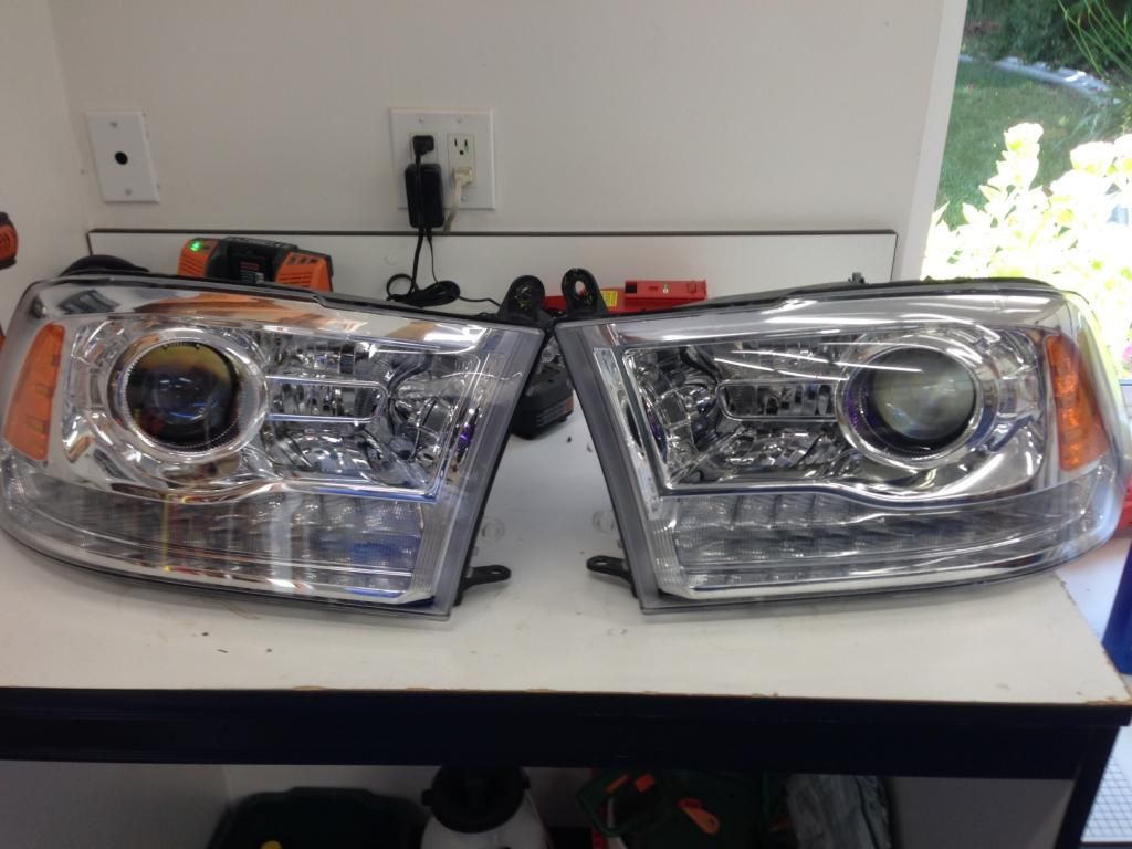

Okay…. lookin for some free advice. I have a pair of perfectly good 2013 Laramie projectors just sitting in the shop waiting for me to grow a pair and crack into them. I get inspired when I see some of the work that you all have done adding HID's, Halos and some pretty sweet paintwork….. then I watch youtube videos of dudes cracking open the lenses on various types of cars and I get mixed messages and see some pretty sloppy results.
So… if you've baked a set of 4th gen ram lights please feel free to set me straight. no need for a poll… just thoughts if you want to share.

see how they stare at me….. taunting me …..

Ok so I did this to my Chrome Projector head lights recently. They are a bit of a pain in the arse to get them open, or atleast mine were. Took about 45 mins per headlight of baking, prying, rebaking, prying some more, hitting with the head gun and then they finally opened. I did not damage the lights what so ever, however the housing gets a little misshaped it can be easily fixed with the use of heat gun and pliers. I recommend removing all the old stock hard, dry butyl tape and purchasing a new roll to seal them back up. A roll can be purchased here for $15: http://www.theretrofitsource.com/acc...bber-glue.html
I disassembled mine and painted them PX8 black and clear coat, which can be painted purchased here: http://www.automotivetouchup.com/tou...paint/buypaint
I installed Halos from aacstyle: http://www.automotivelightstore.com/...LEHaloKit.aspx
For the Halos make sure you buy a voltage regulator as these products tend to fail if there are any voltage spikes above 14V, which is almost 100% guaranteed to happen with our trucks. Let me know if you have any questions at all. Here are a couple photos of my finished project
