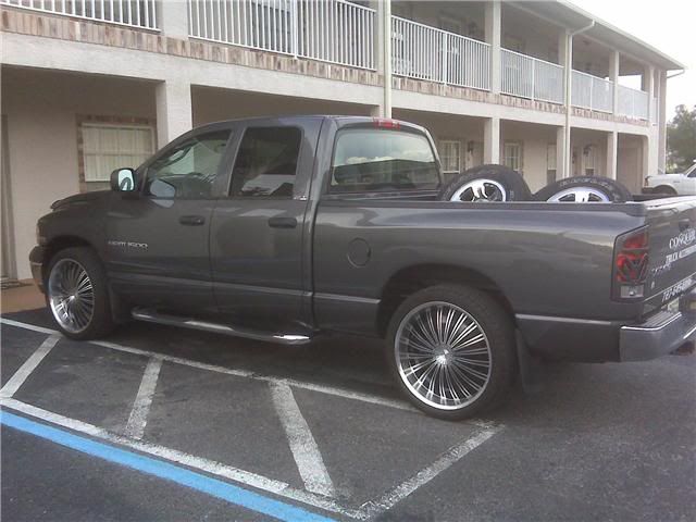

well im working on getting a flip kit for my truck.it actually places the real leaf springs under the axel instead of on top and will come with new suspension for the front which will lower the front 4 inches and the back 6.i have 24" rims with the smallest tires possible for a truck which already gives me better grip and handling but i rode in a lowered one with a flip kit n it felt like it was on rails

i have 24's with a 4/6 drop the only issue i had was the tires in the back hit the bed on big bumps the back is a flip kit and the front is spindels and springs the mcgaughys drop kit

the 4/6 drop can only run 30" or smaller tires i have 255/35r24 and thy are right at 30"
