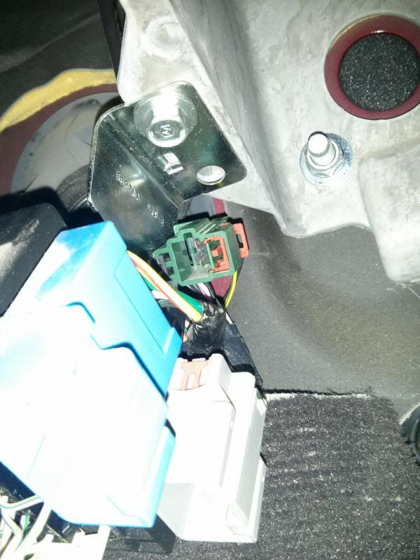

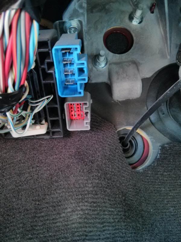

I have a 2009 dodge ram 1500 and I want to add the oem trailer brake controller and I discovered that I have 3 plugs, a blue one a gray one and another green one. I was wondering if I have the right set up for the oem brake controller. Can anybody tell me if its the right set up?
The 09 is set up differently and you can't add the OE brake controller. You'll have to go aftermarket.

Well that sux. Does anybody know whats the green plug and the gray one for? I have used after market brake controller and it plugs right up in the blue plug with no problem.
