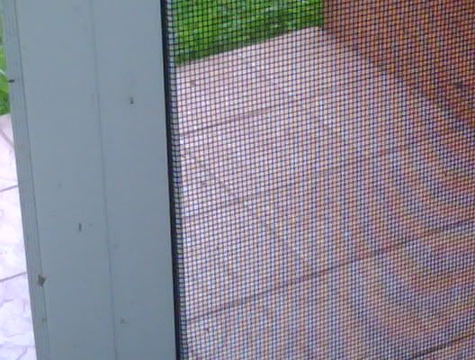

Originally Posted by MightyBlueRam View Post
This is a great idea that you have. I think I'm going to work on this for my truck. I was thinking of getting some of this type of mosquito/bug netting that's on the sliding glass doors. Maybe making some kind of frame to hold it in place right behind the grill.
I don't think this will obstruct too much air flow will it? And it's great for keeping bugs off the radiator.
I took the same type of screening you see here and took the time to cut it to fit for each individual opening for the honeycomb grill from the outside and attached them with small black zip ties, ( I have the black grill of course). It works very well, you can't even see the screen, at the carwash I put the pressure washer right to the screen, it simply pushes whatever bugs are present right through and they simply fall after, no direct spray to the radiator fins, did this from day one, still have a virgin radiator, no debris in the fins whatsoever, this way you don't need a frame to mount it from the rear, let alone accessing it.
