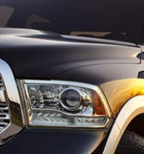

does anybody know if the new headlights fit the 2010 rams?

Yes they do. A member on did that mod. Check it out

Yes they fit. The only issue you will have is the adjusting screw. They moved it in 2013 so in order to adjust them you have to push the headlight in and see where its at. Then pull it out, adjust, put it back in and repeat till you get the beam where you want it.

Also it should be noted these headlights do not plug right up. You will have to do your own wiring and either get the right connector from dodge or do your own mini connectors. Either way you will be cutting into your stock wiring harness.
Currently I haven't found JUST the connector for sale yet.
