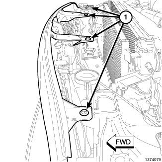

1. Remove the push pins (3) and position the wheelhouse splash shield (2) aside.
2. Remove the fender screws (1).

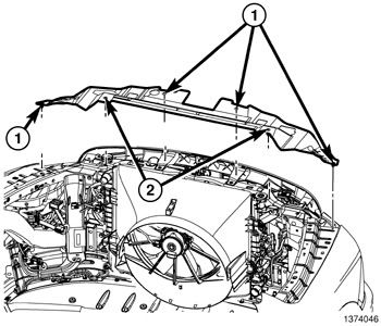

(a.)Remove the four push pins (1).
(b.)Remove the two plastic rivets (2) and remove the upper radiator seal.
(c.)Remove the four upper grille support bolts (1).
(d.)Separate the two lower spring clips (2). Release the two lower hooks (1) and remove the grille.

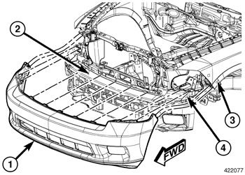

4.Remove the nuts (2) and remove the bumper(3).
