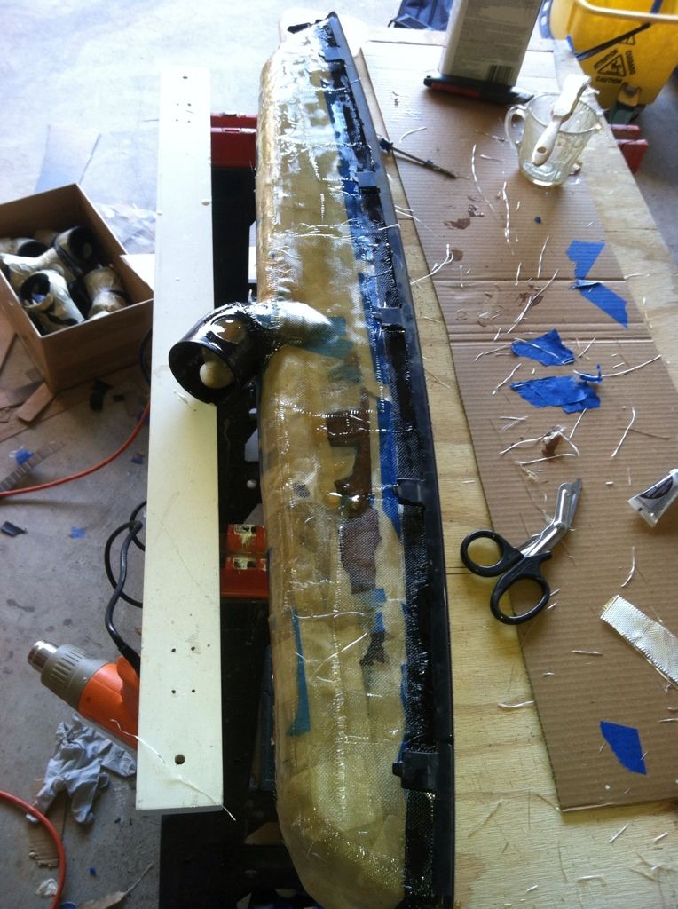

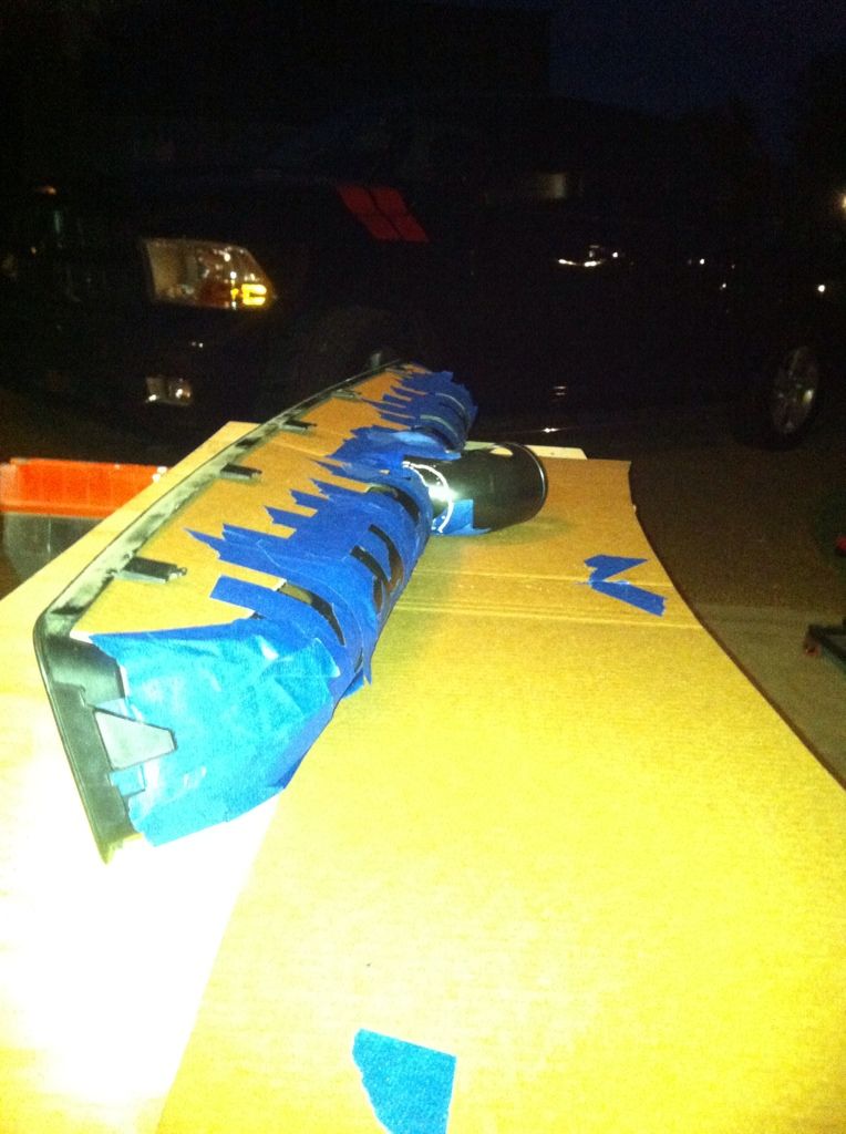

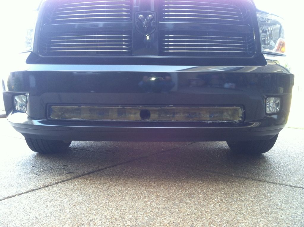

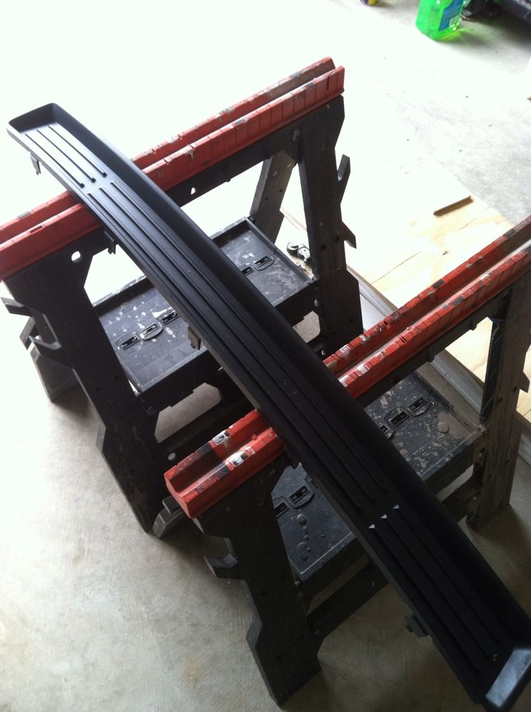

wow great thread. I started a project two days ago, not knowing about this thread until right now. But i am def. using the ideas here to perfect my cold air ram intake. I had planned on using an adapter like this \/ over the stock hole,
then run the ducting down to my fiber glass ram air scoop
i started off with the lower valance
removed the middle, leaving the outer edge for mounting it back to stock mounts later
then i had to cut out the 4 small plastic braces in the opening(already cut out here)
then mocked up the scoop out of tape and card board
then i started laying fiber glass inside the scoop and after it dried i removed most of the card board and tape and finished laying fiber glass on the outside total of 3 layers.
this is a test fit i still have to sand just a bit to get ride of the rough edges the probably just paint it with plasti dip, then i have to decide how to attach some kind of wire mesh or fab up a lower grill to match the stock chrome horizontal grill inserts.
this is the view from underneith. I had to notch one of the braces for better clearance.
might be a bit of over kill, but i hope the larger scoop will add to the ram air effect at speed.

Dude!...that is some pretty neat extensive work there. If it performs properly, you should have a cool ram air system indeed.

Ramfd nice work,how are you going to finish off the grill? black rigid screen would look good or perf. sheet metal,also is that 3" pipe you are using?If you are 4" chimney liner fits perfectly over the flanged ABS elbows and it is perfect for forming bends as well as being rigid, will hold it's shape, light weight as it is aluminum.
