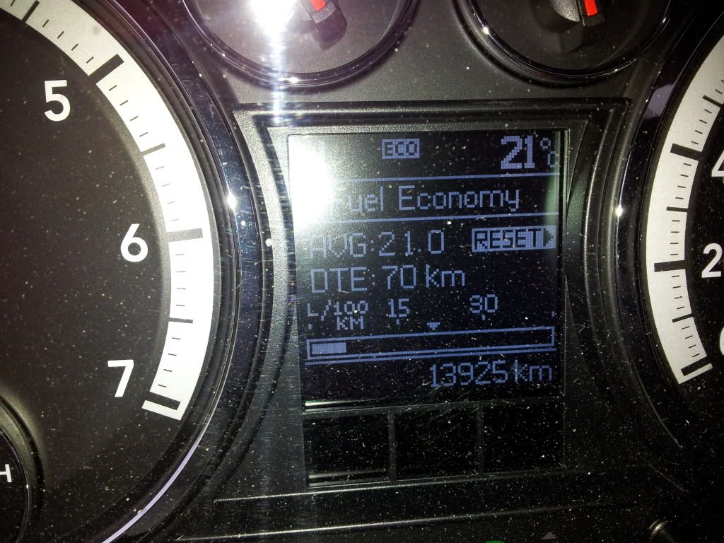

Well I took this pic today after soccer,before the air intake mod it would read 24L/100Kms consistantly (city driving),I think that is a decent improvement and it will only get better when the new muffler goes on,I think it is going to be a flowmaster,I hear the magnaflow has a bad drone in eco mode
It varies between 20.9L/100kms &21.4L/100kms city
