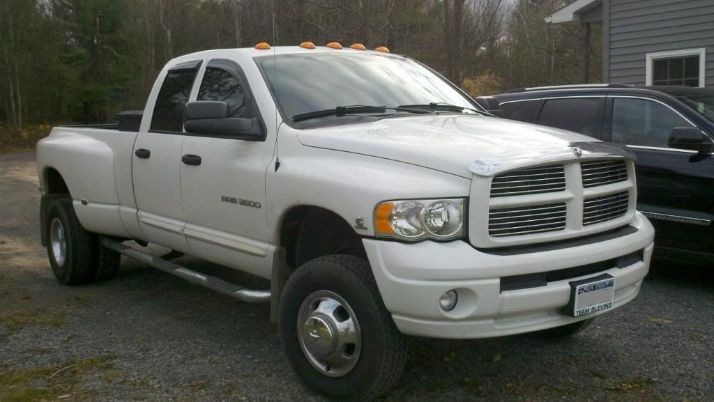

Just installed a 2" leveling kit from roughcountry.com and bilstein 5100 shocks front and rear. So far no issues with it, but if any come up ill post it.
before
after
before
after

Awesome!! You have the Bilsteins set at 2.5"?

it's been a couple of days and everything is still fine. No death wobble yet. My road isn't the smoothest and the front end feels nice and firm. I did notice after the install that the front axle was shifted a bit towards the driver side. So I've ordered a BD adjustable track bar and and looking for a reasonably price set of sway bar end links. Still searching and hoping to find a set of 2555/80/17's in an AT.

The 5100s dont raise the Heavy Duty trucks do they? I know a bunch of Diesel truck guys and they just have 5100s but they are just used as shocks. I was wondering if its the same thing for the Ram. The guys I know have Chevy's.
The truck looks really good by the way.
I doubt you will feel death wobble unless your steering components are wearing out.

yeah the 5100 are only shocks for the hd's.

Make sure you have the front end realigned . Raising the front does effect the toe in . Let me know how you make out on the adjustable track bar . I'm looking for one for my truck also .
