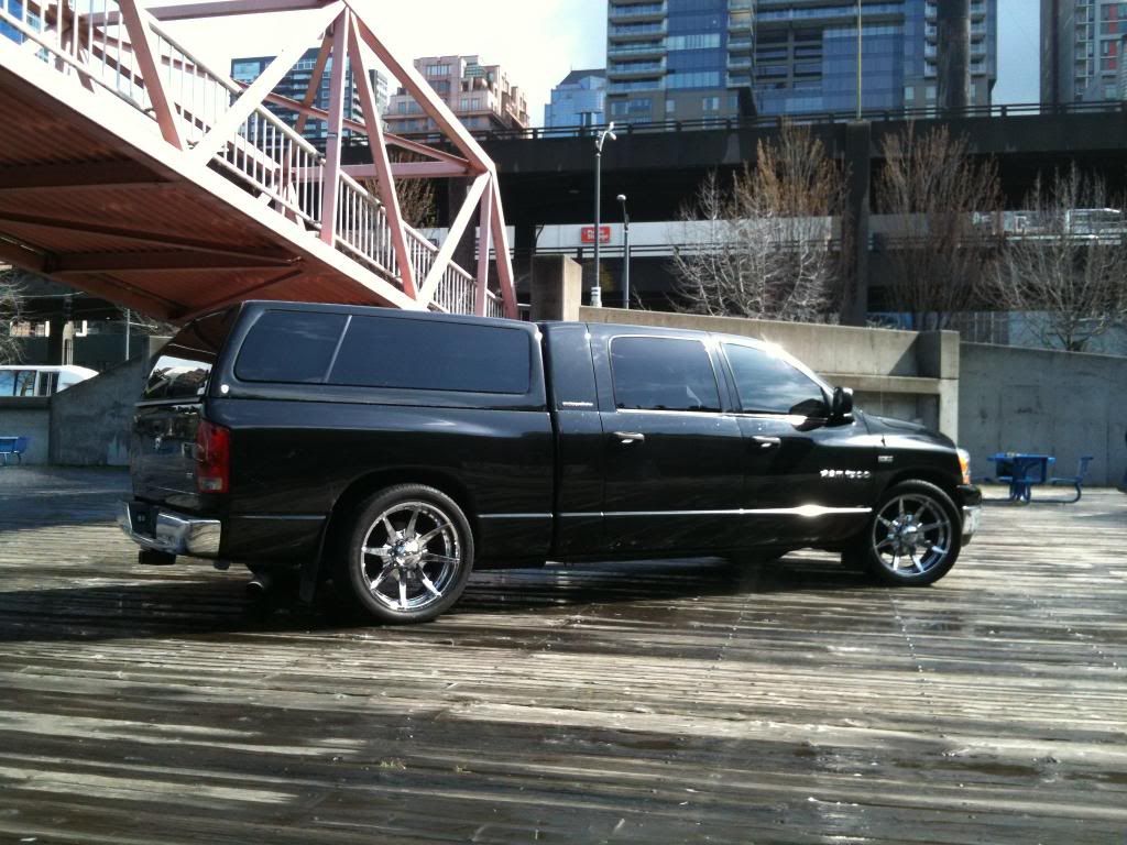

I can't help you with the bump steer, but I sure would like to see a pick of your ride.

There you go Boss...
