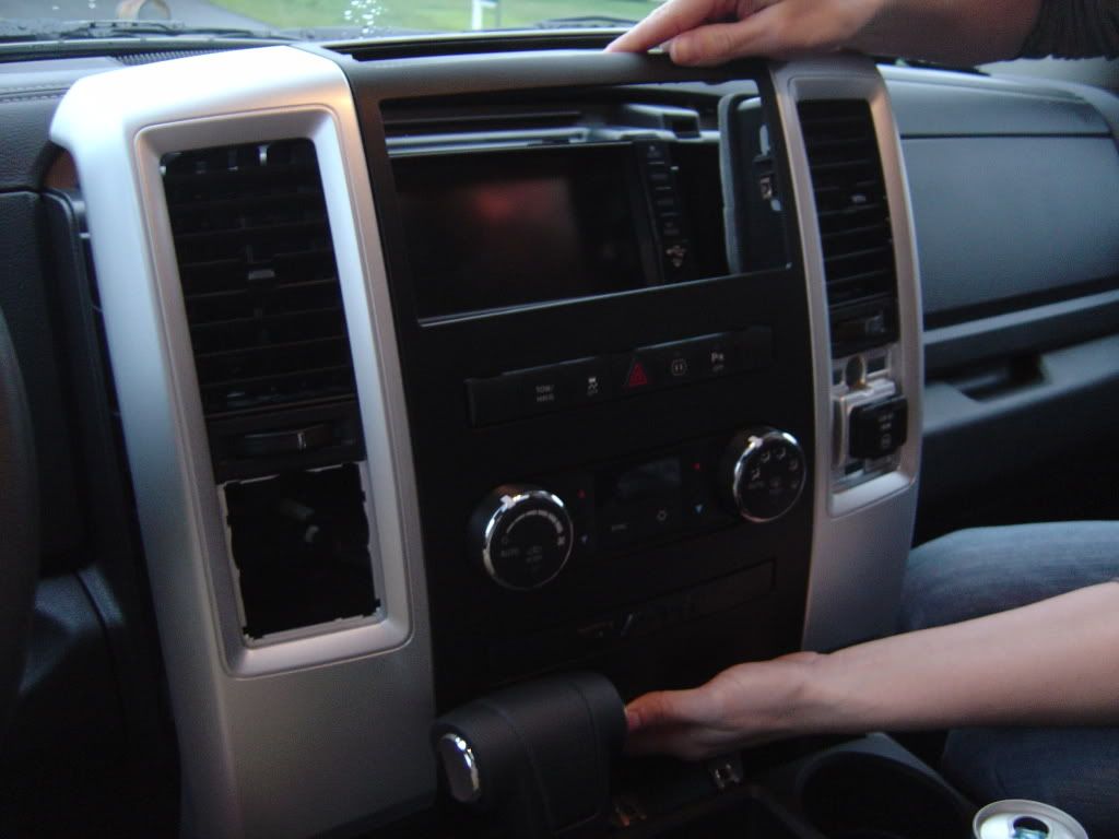

Pics as promised:
Remove the chrome trim piece by pulling up (it takes some force, so be prepared). It helped a bit to push in the tabs as more became visible.
The silver and black surround of the radio is one piece and is held in by tabs and a single screw behind the power outlet. Pull straight out. It helped me to take out the 4WD selector switch and pull from that side first. That's the blank area to the left of the A/C controls.
We didn't have to disconnect all the connections for the A/C controls and such, just pulled the bezel out and leaned it against the shift knob. The radio is held into place by four screws, and they were TIGHT. Use a closed end wrench or socket for more leverage if possible. Be patient. If you have any questions, feel free to post them or PM me.
Oh yeah, I have to say thanks to my wife, she was invaluable as a second set of hands and a calming influence when things were hard to remove!

OK, dumb question but I have to ask, when you say:
"Remove the chrome trim piece by pulling up (it takes some force, so be prepared). It helped a bit to push in the tabs as more became visible."
Do you me pull up towards the roof? As soon as my truck arrives from the factory, I'm going to install one of these but I can see myself with a new truck with 3 miles on it with a broken bezel (and a p/off wife yelling at me).
Craig

Yep, that's exactly right. Start at a corner and pull straight up. If you have a felt wrapped screwdriver or a tab push tool (available at Autozone or the like) that would be helpful, but not required.

I struggled a bit getting the front trim off, as I also have a column mounted shifter (sure wish Dodge would do it the same every time). However, it was as simple as removing the two screws up top, prying the trim off the electrical outlet on the right, and removing the screw under that piece of trim. From there, I just pulled OUT on the trim rather than UP.
