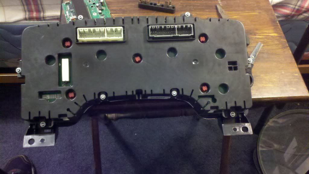

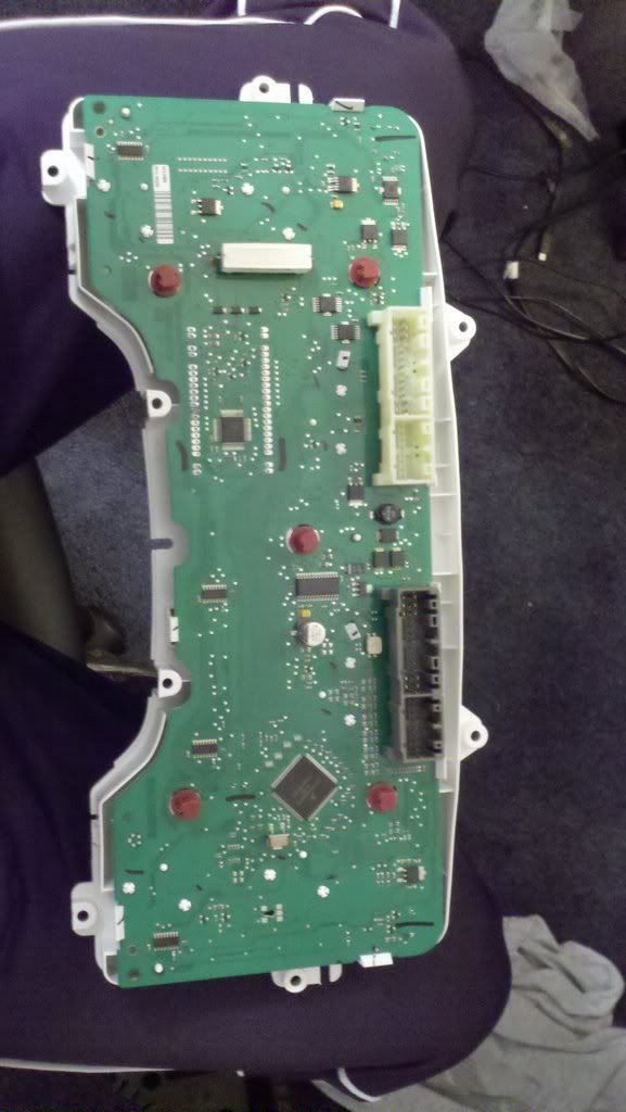

Here you see the back of the gauge cluster with red twist LEDs installed
Same photo with the black cover on the back of the gauge cluster

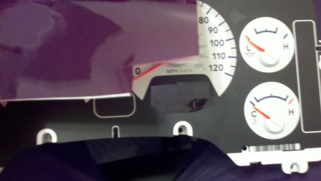

This is the piece of RED RoscoLux gel "tint" I cut out of the roll ($6 on ebay) and stuck over gear indicator section of the cluster.

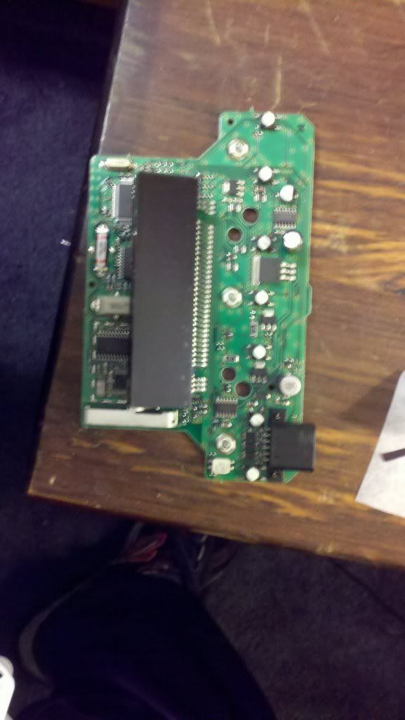

Heres the overhead computer circuit stripped down with a piece of RuscoLux tint stuck to it.

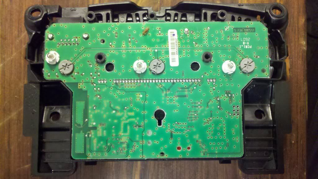

This is the back of the overhead control circuit with the new LEDs installed with the old factory bulbs beside each LED
