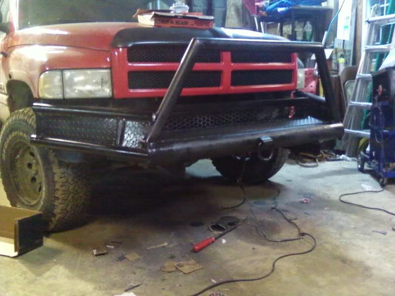

Sorry it took so long to get a picture, been doing other work to the truck as well. If you want more pictures let me know of what you want

Good job!
Its nice to build things yourself! Is that pipe or tubing? What kind of welder do you have?
Save up for a tube bender and you can take a bumper like that to a whole new level!

Its all pipe, 1/4" wall. I have a hobart 187 MIG welder. I use the flux core wire though instead of buying gas. After I finish up this ten lb spool, I will be switching over though. I would love to have a pipe bender, especially since my next project is my F150 which will have a similar bumper, a full roll cage, plus I wanna make some rock sliders for both trucks.
