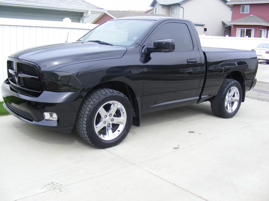

Originally Posted by clatla View Post
Are you using spacers? I didn't think they would fit without them.
No spacers, no rubbing and dropped 2/3"
...from a previous post ...
Someone ask for pics?
305/50R20 Terra Grappler's on my Lowered 4x4
The Ride is night and day difference ! Winter Traction is amazing for snow/slush and ice.
Stock 275/60R20's vs 305/50R20 Terra Grappler's (actually measure 12.2"x32.2")
stock Good-for-a-Year tires / stock suspension
stock suspension 305/50R20 Terra Grappler's
After 2/3 drop kit 305/50R20 Terra Grapplers

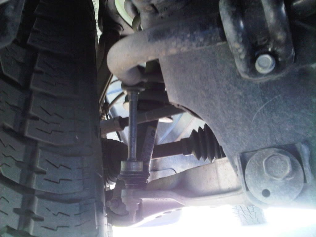

..just before drop install...
Here's the clearance to the upper control arm on my 305 wide (12.2" wide tire) no rubbing, even after my 4x4 was dropped.
I've heard a 2wd will rub the sway bar at full steering lock though,
Here's my passenger side tire sway bar clearance at full left turn lock...
