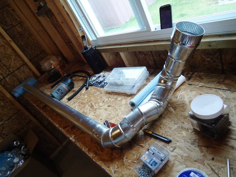

Material:

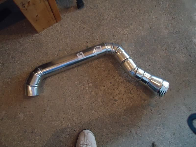

All cut to size:

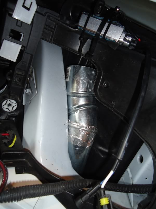

Ran behind the headlight (as close to input hole):

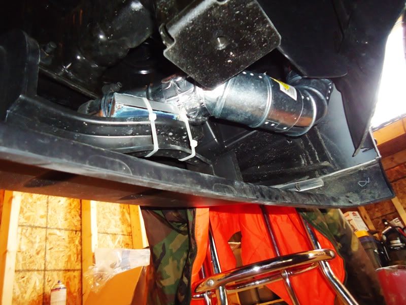

Ran to bumper opening (This was rough work, ziptied, foamed everything later):
Run:

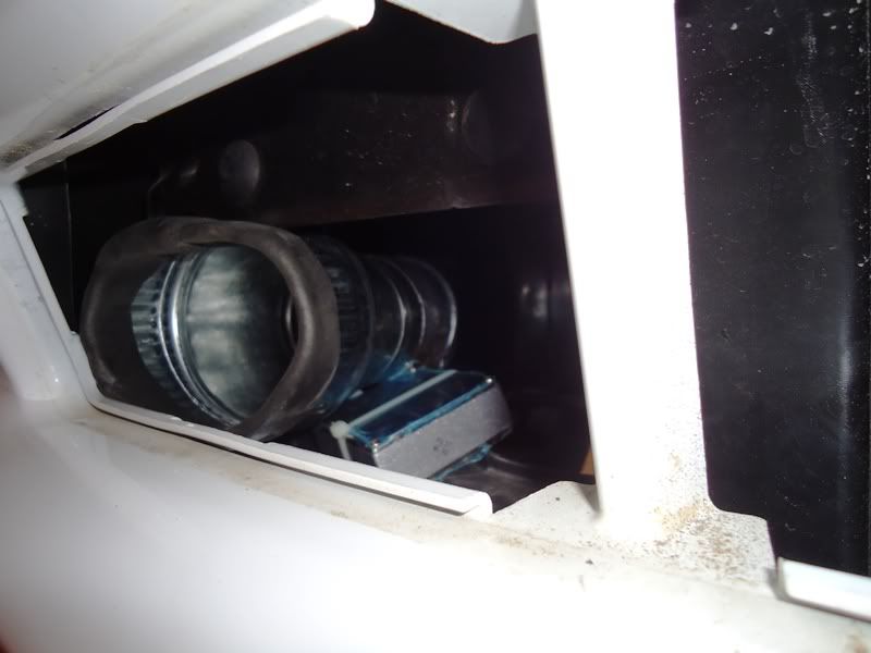

Slotted:
Complete I sealed off behind the headlight with aluminum tape just to create a touch more suction
