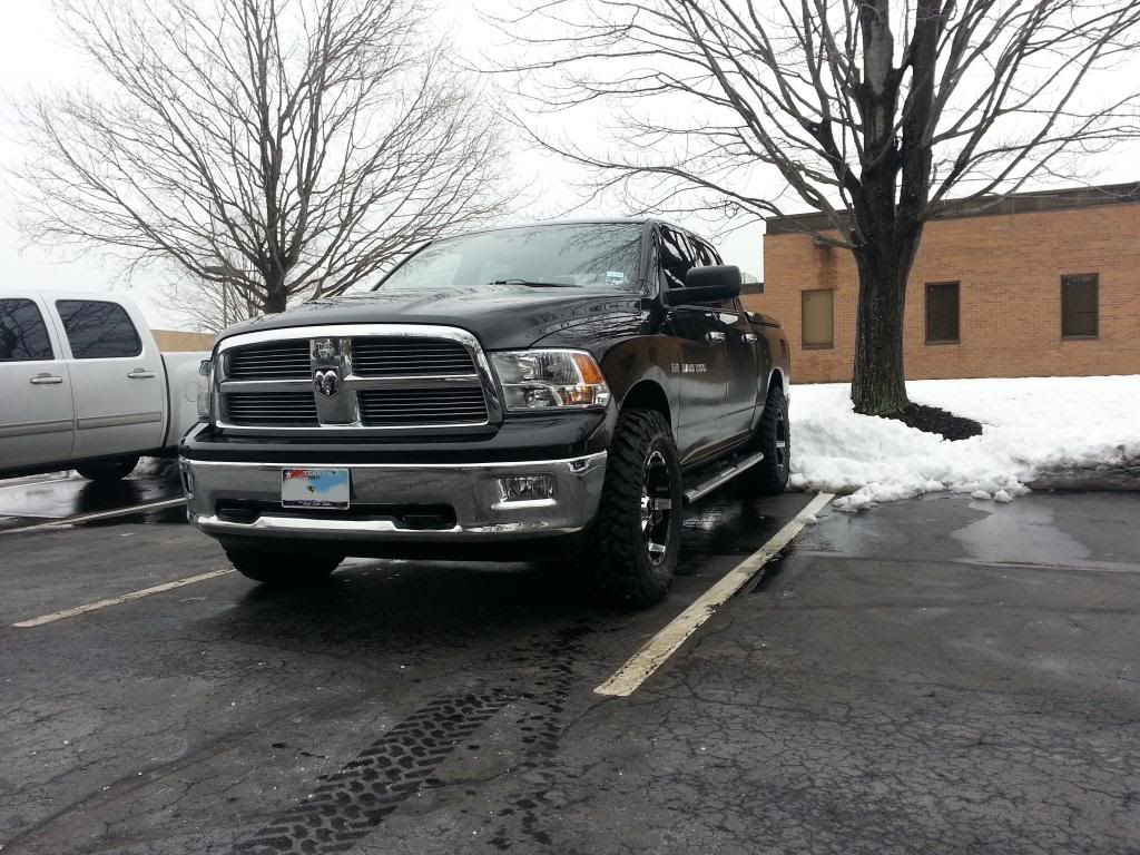

This was the initial rim I was going to go with and didn't know how it would work with black. Looks amazing on your truck.

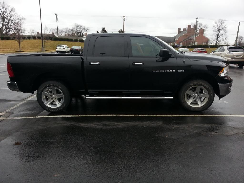

Hello all,
I've had my truck for a little over a year now.

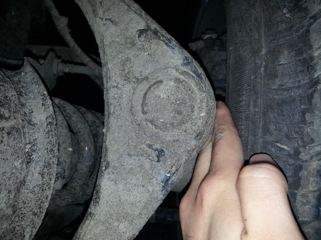

My original plan was to put Nittos on the stock wheels but when I took my truck to Discount tire to fit on some 295/60r20, they rubbed the upper control arm... Thats when I learned that if you want to put anything wider than a 275 tire on 2012 4x4 Ram 1500s you have to buy new rims with a smaller offset (stock is +19mm). These XD Spy wheels have a -12mm offset.
So far I have a 2" level, XD SPY wheels wrapped in 295/70r18 Nittos, and a Leer 700 bed cover. I just ordered some fender flares and will post pics when I put them on. Next month I will add a 4" lift kit and post pics as well.
Thanks brother. I'm extremely happy with them. I couldn't stop smiling as I drove away from Discount Tire.
4"Rcx, 18x9 -12 XD SPY, Nitto Trails, Leer cover

NP!
Simply looks mean.
Almost makes me regret not going with them.
