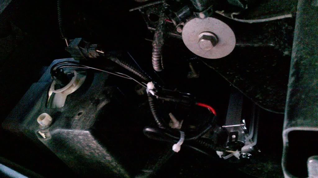

Here are the ballasts mounted for the fogs.
Another shot of the ballasts for the fogs.

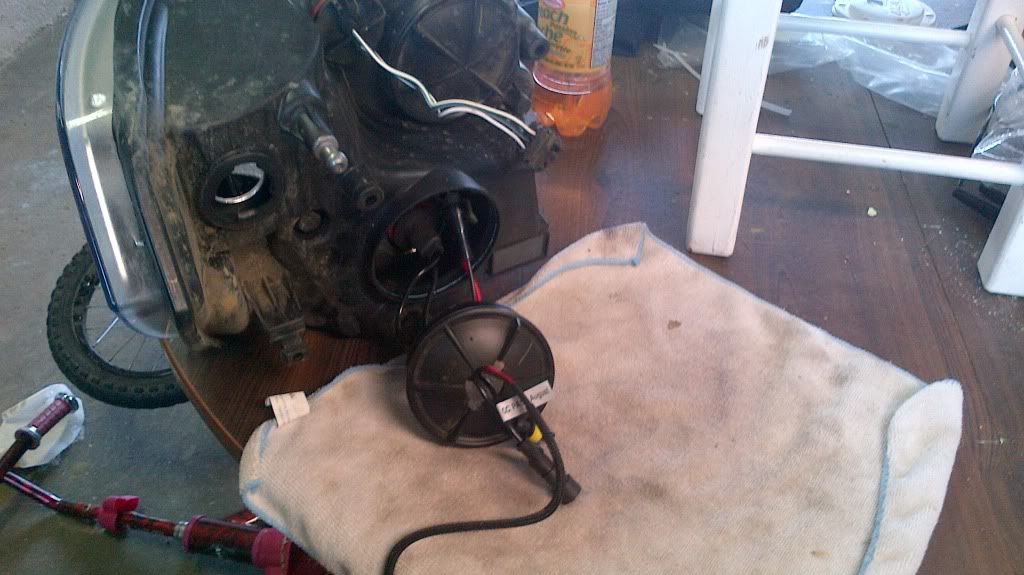

Once you pull the headlight right out you need to open up the back of the bulb cover to allow for the installation of the HID bulb and power supply. I used a 7/8" bit to make the hole then opened it up with my dremel to allow the power connector to go through.

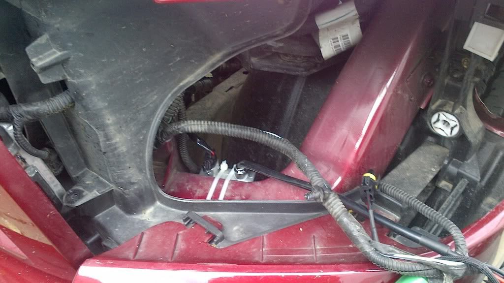

I didn't pull my grill and worked within the opening with the headlight out.
Here is a shot of where I mounted the ballast for the lows.
