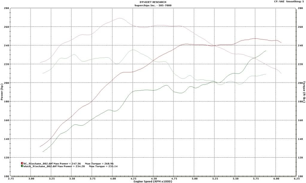

Here's the dyno sheet for a 2009 4.7L ram with 91 performance tune. The 93 tune gives approximately 3-6 more hp they told me.
Pretty impressive. Can't really get that anywhere else for a few hundred bucks, especially something that only takes 15 minutes to install and uninstall...
