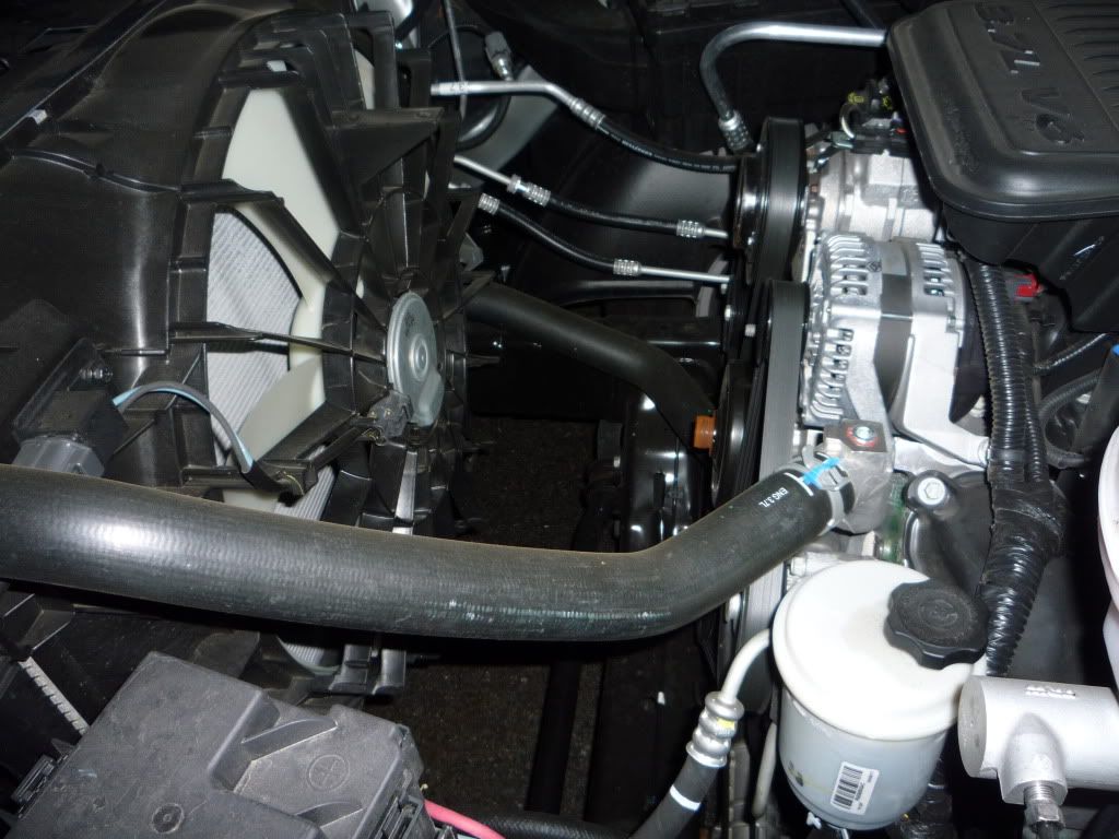

Just want to comment that you really should have a shroud around the fan, it makes a drastic difference.
It's a good idea, that's why I did mine that way, but plenty of guys are running them on the v8's shroud less w/o any issues. Here is a pic of what the 4th gen's stock e-fan looks like on the 3.7
Just look at all that room for an underhood intercooled turbo setup! Just need someone to step up and come out with a tuner for the 2012s. I pick mine up tomorrow night...

Gotta change your pistons if you're going to add boost, whole reason they stopped mking that kit for the 3.7's in the first place. High ring lands were breaking.
