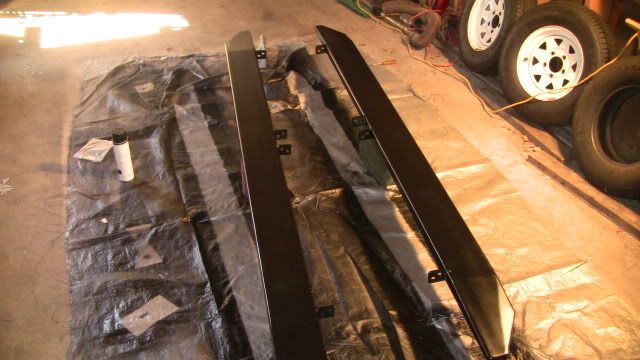

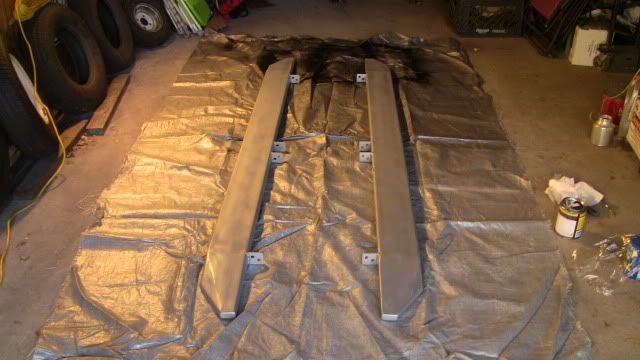

hopefully by tomorrow these will be ready for install. I decided to use a pretty nice product called Chassis Saver and then top coat with Monstaliner Bedliner. The chassis saver is indestructible and monster liner is a hard protective surface but still gives a nice grippy texture.
I also sprayed an internal rust proofing used for car frames to rust proof the inside of each rail.
Here are some paint pictures, when the Chassis Saver dries tomorrow I will top coat with the Monstaliner. and install.
Silver - Aluminum primer coat
antique black top coat

I coated the tops of the sliders with the Monstaliner bedliner.
