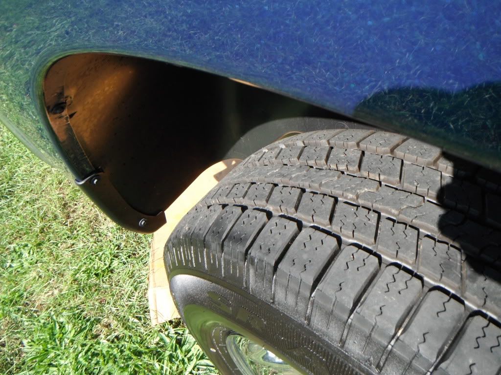

Something fishy on the rear end, it is rusty, but the brake cable looks new so the rear end has been changed out? the diff cover shows it has been serviced ( gasket sealer on bolts and oozing out the cover ) and looking at the side of the bed, you can see there was some repair, the top rail of the fence in front of the well has a "jump" in it where the body has been repaired but not perfectly... apparently this truck was hit in the side at one time or another dented the bed as well as prbly damaged the axle so the axle was probly poorly repaired or replaced with another damaged axle thinking it was good because some placed buy salvage yard parts since they get a steep discount, and whoever did it did it under the table or "hid" the damage ( possibly traded in to the un suspecting dealer ) there are lots of possible reasons.... but to me it looks like there was a cover up... if it was done at a reputable place there will be a car fax on it... if done at a small shop or DIY then it wouldnt show up on car fax.
Does the title show factory new or was there a previous purchaser? (Dates on title will show when transfered )
Mike

Good eye sonocativo. I didn't notice any of that. Looks like it could have been tboned in the bed possibly during a test drive or when a salesman took it home. Look up the car fax and see if it's on there or the dealer that traded it to the dealer you bought it at could've fixed it at their shop or a shop they're partnered with and not reported it

There should be, but Im not sure, a list with part numbers used for that build and you can possibly check to see if they match... It would have to come from the factory Im sure or at least in their records that corporate could get very easily.

also those bolt heads are not rusted where the rest of that backing plate is all rusted...that dont add up at all, something has been majorly done to that rear end, that is not factory as the sway bar still looks new.

Correct, I have bought half a dozen new vehicles, and even in the salty NY winters, they NEVER look like that when new. That vehicle should be PRISTINE. I would raise absolute hell. I would definately own that dealership by the time this was over. from what I can see you have:
-Rust EVERYWHERE
-Obvious body repair. Repairing a bedside panel never goes well, they need to be REPLACED when damaged.
-The diff sealant (could be explained by a recall, check service history)
-Overpayment. Your father had CASH. And he paid 35k for an ST with a chrome appearance package. It does not even have the entire chrome appearance package. It is supposed to have chrome door handles too. Not to mention its a 2011, and the 2012's are on the lots now. They should have been begging you to take it. He could have gotten this truck for 25k EASILY, maybe less. I smell a scam. Dont feel bad, BS like this happens to good people every day. I would be calling an attorney if I were you, this is not right, at all. That rear end was changed. The replacement was rusty so they half ass spray painted it before they put it in. Then they scraped the paint with the axle-jack when they were lifting it into position. If I was going to go so far to scam someone, I SURELY would have done a hell of a lot better job covering it up.

There is no rust anywhere else but the whole axle.... something fishy there for sure. The wheel well liner is not lined up correctly and there seems to be what looks like a space where one of the mounting screws possibly ripped out due to an accident...
The plate over the axle only has rust in the center like it was masked and sprayed but missed it entirely, missed alot on the carrier and axle tubes ( not properly cleaned before painting... Hair in the back seat and coffee stains on door, must have been the poor souls in the truck who got creamed having breakfast on the way to work and paramedic dragging them out. Look at the door panels and see if there might be an impression, look at window seals for tears and glass particles, anything on the floor under seats around the seat mounts ( hardest place to clean glass from )
are the gaps on each side of the tailgate even ( usually not after a side impact )
