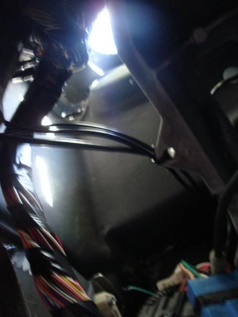

I got this 12" e fan out out of a 94' Ford Thunderbird SC. It was used for the intercooler. After figuring out how to mount it, I decided to put it in front of the tranny cooler.
You can't see it from here but, I had to trim the edge of the shroud to get it to fit over the oil cooler
Power, source and ground wire all ran together
Ground wire for my switch and e fan along with the source wire
Source, ground and power wires ran to the switch through the rubber boot on the driver side firewall
Wires that come through the firewall and ran to the switch
That plastic piece became useful for something
All together it took me about 3 hours to do.

that's the tranny cooler that the fan is mounted to..you have the tow package cooler as well (more rows than stock cooler)...nice mod cuz the fluid has to stay as cold as possible...

Chefred...It is...I just went out there and looked. Before I didn't get up underneath of it all the way. The lines clip to the top edge of my oil pan and I just figured it dumped into my oil pan but now I see that they go all the way back to the tranny. Wow...I feel like a dumb @$$. haha. Oh well, it'll still help. Thanks
