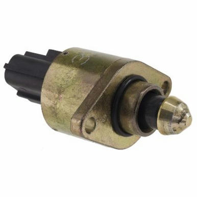

Now if only I could find the source of my whistle, I'll be set. I just ordered a Mopar IAC to replace the cheap one I bought from Advance Auto. It is either moving too slow, not working correctly or shaped in a fashion that it causes a whistle as it constricts down the idle circuit...
The black one is the OEM and the metallic one is from advance auto.

You know my 4.7L (2010) makes a whistling noise when you rev it and it returns to idle. It's only noticeable with the hood open.

Mine may have done it before too but if it did, I never noticed it. It may be worse now that the engine is tight again and moving more air.
I can hear mine in the cab as I drive down the road. It's louder if I rev the engine like you describe but it's there enough to hear if I let off the gas to roll up to light or stop sign.

hmm yeah I only noticed mine the one time when a buddy and I were working on it a few weekends ago, when I would rev it, as it returned to the idle rpm it would whine/whistle for a couple seconds.
