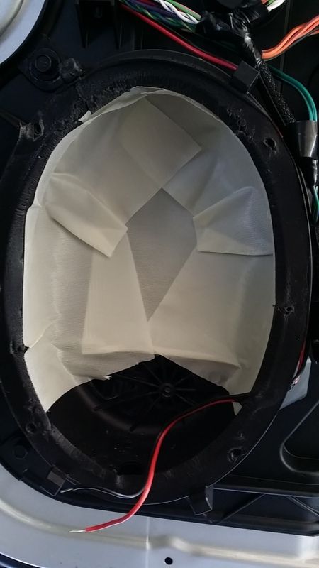

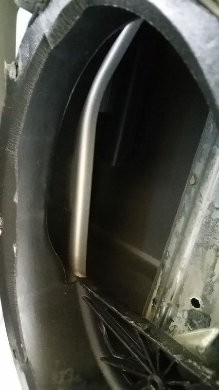

Hey guys. I'll update my build a bit. Since I finished my build I have been playing around with everything trying to get the sound just right. While doing that I noticed 2 things that wernt quite right. Mid bass impact and subs sound lifeless like most people suffer with, with under seat sub installs. Well to remedy the mid bass issue I decided to fiberglass some pods in the doors so my mids would have a sealed enclosure to bring the mid bass presence back to life. There is plenty of room in there so i just took some polyester tape and made a shape I liked and glassed away. Pretty easy actually. Here are a few pics I took while Making the pods.
