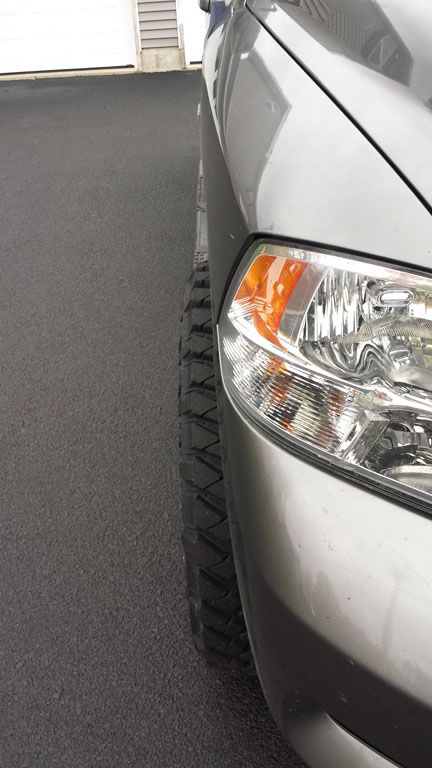

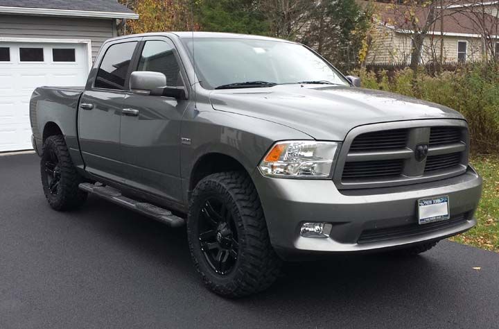

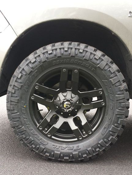

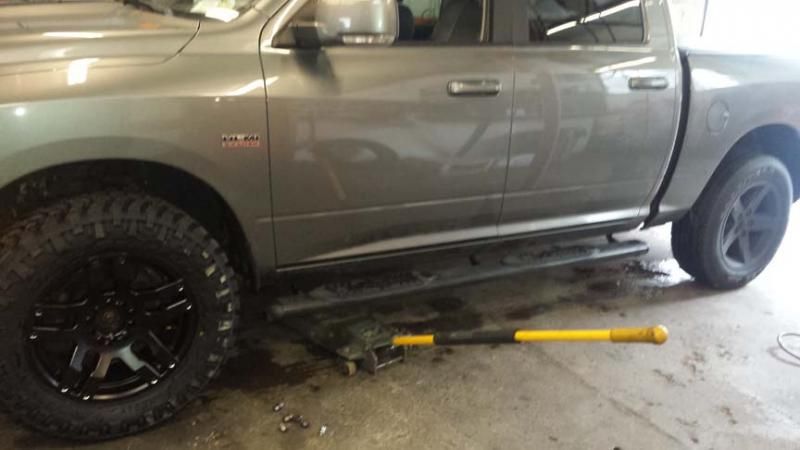

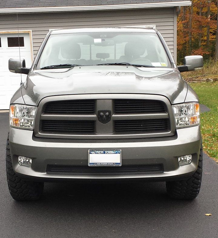

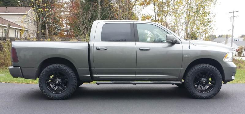

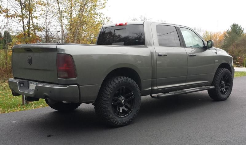

OK here is my 2011 Ram 1500 Sport with a Bilstein 2.8 Level, 35x12.5x20 Trail Grapplers, and 20x9 Fuel Pump Wheels with +1 Offset. Took me forever to decide on this combo but I am very happy with my decision. The truck looks MEAN!!! Finally feels like I'm driving a 4WD Truck!! Thanks to the guys on this forum who helped me with my questions!!

glad to see you put the right side of those tires out like me! I think they look less aggressive with the other side out. I love my pump wheels too!. Good choice!

Thanks!!. I'm not gonna lie, your truck helped me make my decision!!! LOL got all your pics saved on my computer.

looks great. i wish i had gone with your offset!

Thanks!! I was considering the -12 offset but I didn't want them to stick out to far because I really don't like fender flares. Now they stick out enough to give it a good stance but not to much. Hopefully they don't kick up to much snow once winter hits.

Hey man your truck looks sick! I was going to go with the same tire/lift combo on my Outdoorsman, except I'm going to run 18's. If you would've went with a, lets say -24 offset, the tires would stick out more right? and if so about how much? thanks and again, truck looks awesome!

A -24 offset will have them stick out a little less than 1 inch more than his +1 offset, which currently are about .7" out further than stock.

Yup that looks nice with the +1 offset. Mineral grey is a great color as well.
