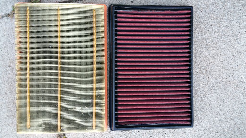

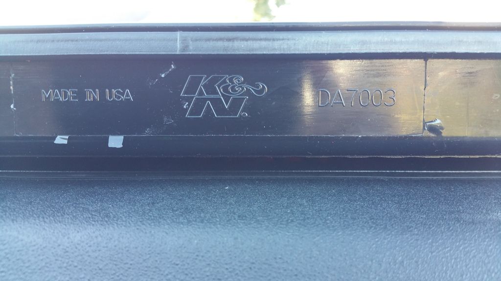

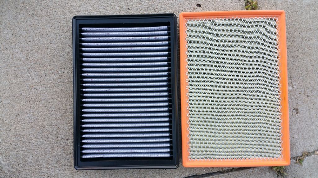

I just dropped in the Dryflow AEM filter purchased through AutoAnything. I didn't realize that these are actually K&N filters, as their name is stamped into the rubber gasket. Install was as simple as opening the stock airbox and replacing the filters. I didn't notice any increase in sound or butt dyno performance increases, however the filter seemed very well made and was very sturdy.
Attached are a few photos to compare the stock filter to the AEM. Stock filter is orange while the new AEM is black and red:

The factory style filter has a *ton* more filter element. If you could deconstruct the two of them and stretch out the element, you'd see that there is more surface area in the factory style.
The new factory style filters also seem to be a bit better, as they're roughly 1/4" thicker, which means even more filter area. More area means less pressure drop.
The replacement filters look like less than half the pleats, which means a corresponding drop in filter surface area. To maintain the same flow with less area you need to decrease filtration ability. It also means it will plug up faster, with a corresponding increase in restriction.
I have seen used oil analysis results (one of them my own) that show an increase in silicates and wear metals after switching to a K&N filter. Silicates are dust and dirt particles getting into the engine. Those trends disappeared once the factory style filters were reinstalled.

Nothing about that AEM filter looks "better" than the OE piece. Look at how much smaller overall the AEM is.... That means that there is less filtering media so in order to increase airflow you have to actually FILTER LESS which means letting more contaminants into your engine :4-looney:
I know its your truck and you can do as you wish but the stock filter will flow wayyy more air than a stock or even mildly tuned hemi will ever need. AND it will actually be capturing dirt!
It really is so simple but people will never stop believing the advertising claims. If you want real horsepower gains you have to pay and that means forced induction/spray or a stroker kit.
