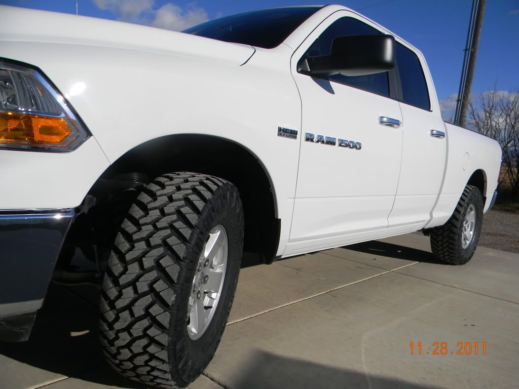

I'm running 295 75R 17 Nittos on my 2011 no rubbing. Just a leveling kit.
Is this on a ram 1500 Crew Cab? Wow, i bet they look great. I would love to see a pic if you have any.
So it sounds like i can order the 285/75r17 with no concerns.

Either size will fit no problem, especially with the leveling kit.
Greta truck, they look really good. It looks like a real truck with those tires on. Did you have to recalibrate your speedo or transmission?
Outfitr
What size are your rims? 17x7?
What is the offset? +25mm?
Do the tires stick out of the wheel wells?
Your pic has made me want ot go for the larger 295/75r17 but i dont want them to stick out and throw up a lot of crap along the side of the truck.
cheers
kev
Thanks. Rims are just whatever the stock size are. Offset ??
I've since put the factory molded mudflaps on and splatter isn't too bad.
And I did not recalibrate speedo or trans.
Outfitr, That looks awesome! I'm glad to see someone with big tires on the stock 17's. I have the same wheel, which is 7" wide, but I've been worried about putting bigger tires on it like that because on Nitto's website it says the minimum approved rim width is 7.5" for that tire (I'm assuming that's the Trail Grappler). Have you had any uneven wear down the middle of the tread? Wouldn't think half an inch would make much of a difference, but you never know.
