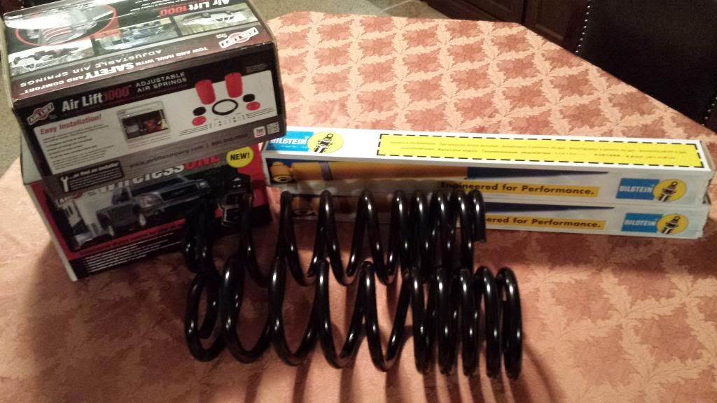

I just had the Air Lift 1000 bags installed in my truck, along with the Air Lift Wireless One system. I wanted to beef up the rear end a little more still, so I had a pair of TufTruck HD variable rate rear coils (1223-V) and a set of Bilstein HD 4600's installed along with the Air Lift system. I will say the TufTruck coils weigh about twice as much as the factory installed coils. I haven't had a chance to see how everything performs when hauling or towing yet, so I can't give any opinion on that aspect. But, the ride of my truck (with 5 psi in the bags) is just as nice, if not better than stock.

I ordered the bags, wireless controller, and shocks from Amazon. I ordered the coil springs from sdtrucksprings. I had a local truck place install it all for $325. :smiley_thumbs_up:

If you are asking me, I ordered the same bags (part #60818 ) as you would with the stock springs. The new coil springs and shocks I added kept the same stock ride height.
