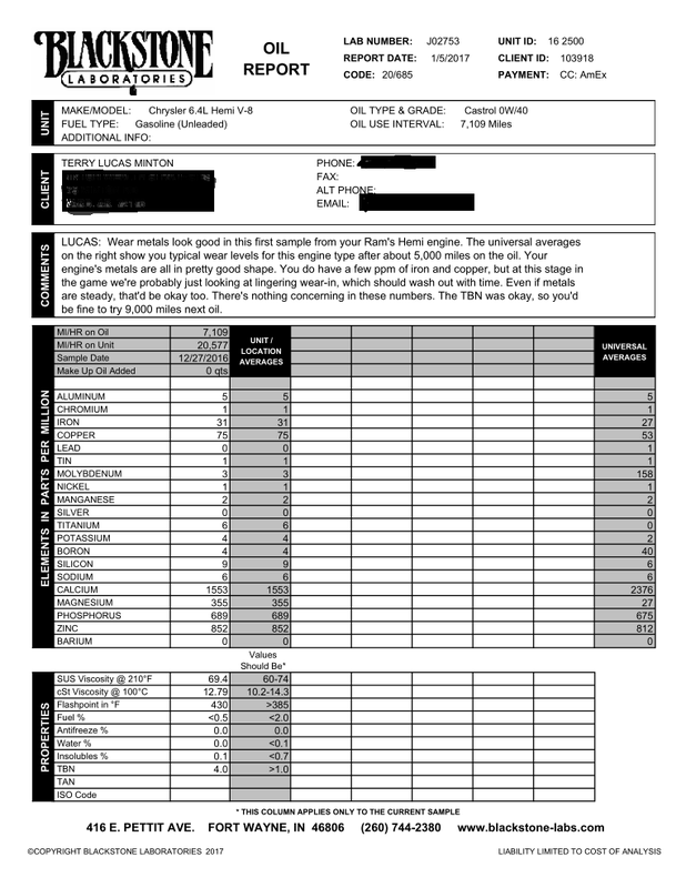

Just like it says, I changed oil about 10 days ago and got my report from Blackstone Labs Thursday. It appears that my motor still isn't broken in at ~21K miles and right under a year later.
To date I've done 4 oil changes, 2 previous with Rotella 0w40, 1 with Castrol 0w40, and currently it has Rotella again. I'm going to run the tests on the Rotella as well.
I use the larger diameter Hemi filters, either Purolator Pure One (gold) or Wix. The additional filtration might be the reason for the Blackstone Recommendation for a 9k oil interval.
I'm going to run the Rotella for about the same amount of time and see what I come up with.

Can you post a bigger picture? Even when clicking on image it too small to read

Thanks for posting, but its like 1"x2" and impossible to read. IDK if you saw my UOA, but I cropped it in MS paint and covered up my personal info and then uploaded it via the gallery to get it to a legible size. It took like 4 tries to get it right lol
Grrrr, I thought it worked after I posted.
This should be legible to anyone!

Yep, I can read it now

Interesting report. Crazy to think Copper that high is normal, guess Im used to the BMW world still that if you see anything higher than 15 you have bearing issues! I have a blackstone kit and Im curious to get it tested with my 14 having 19k miles on dealer oil changes.
