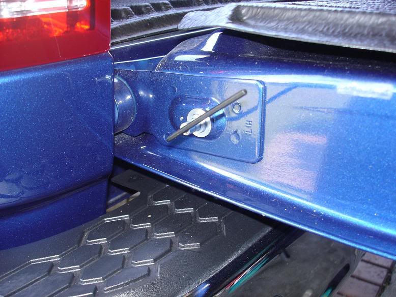

First I removed the safety cable from the pin.

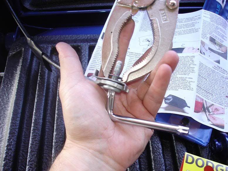

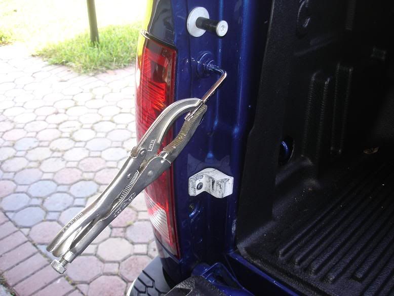

Then removed the pin from the truck. I had to use some pliers as a lever because it was tightened real well.

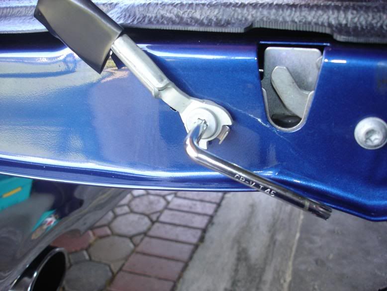

Inserted and tightened this fastener into an existing hole in the tailgate.

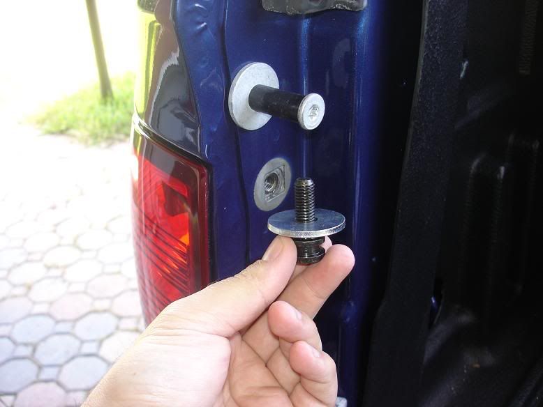

Removed the fastener on the tailgate that hold the safety cable. This also was tough to remove at first.
Then, instructions say to remove the washer and travel stop. This left me wondering why as they don't really give a reason to remove it. The washer was imposible to remove with tools.
Then reinstall back on the tailgate.

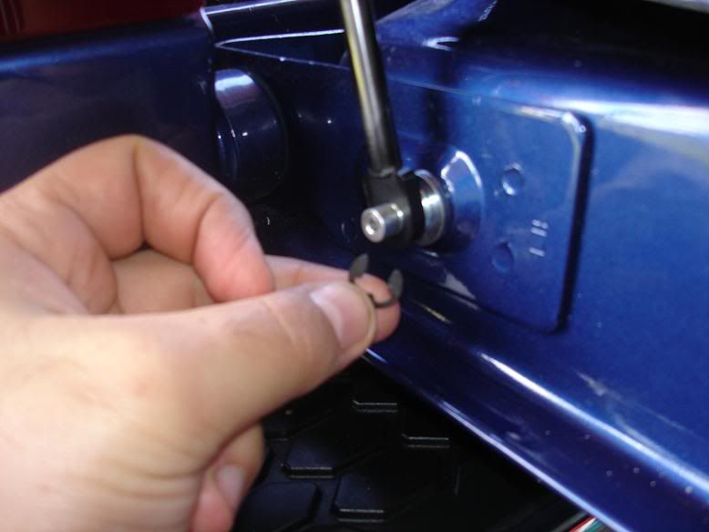

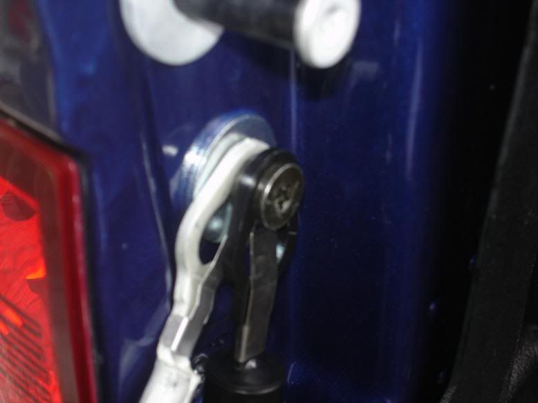

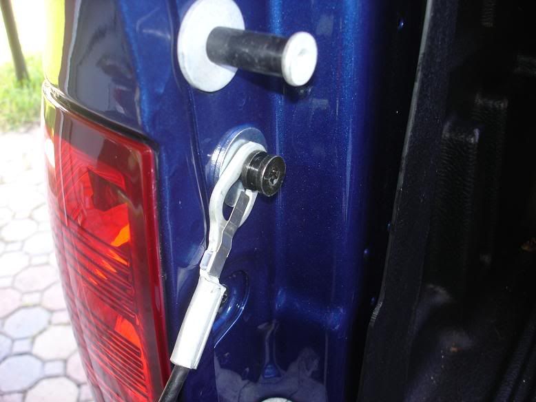

Attach the EZ Down to the fastener and use the E-Clip to secure in place. In the install video, they use a nut, so this is one difference I noticed.

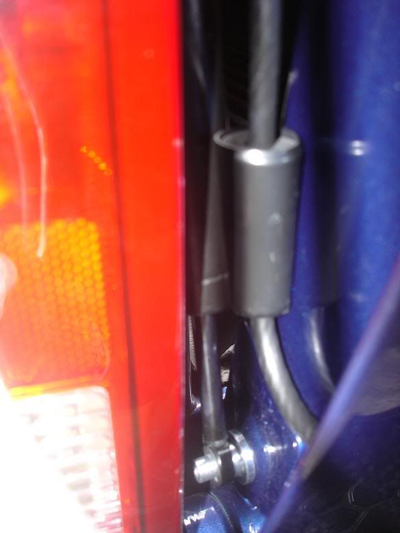

Attached the other end of the shock to the truck.

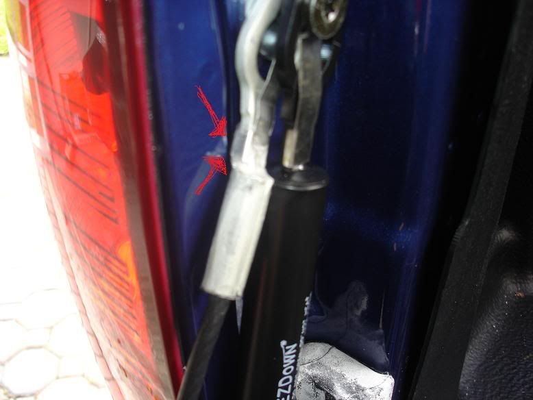

Heated the heat shrink tubing with a lighter and trimmed excess.

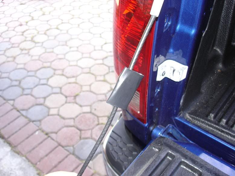

The bumper is used to prevent the cable from getting pinched when closing the tailgate.
Once alligned a zip tie holds it in place.

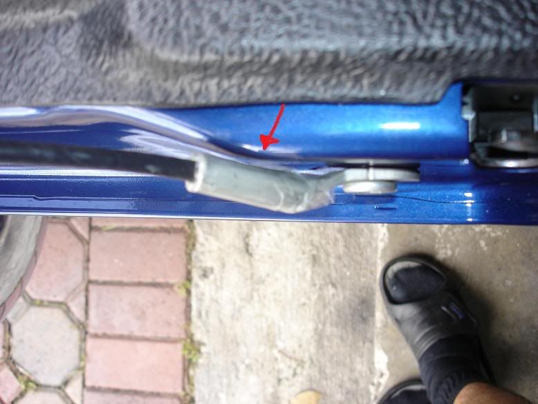

I noticed that there are some parts that rub slightly. I am going to buy some heat shrink tubing and cover the parts that rub but for now I just wrapped it with some clear packing tape.
