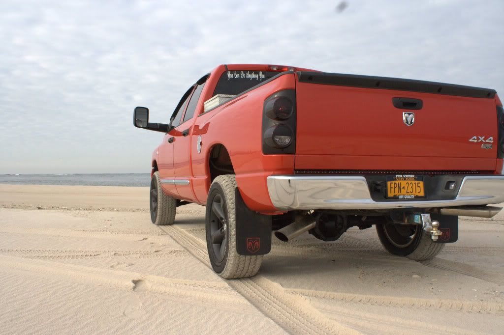

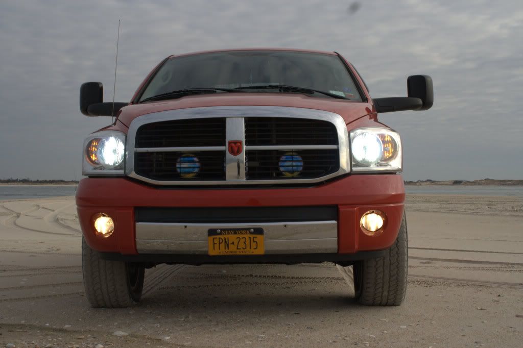

well, today was my first time ive ever taken my truck out on the beach. i need some help though. In soft sand, with this lo pro tires, what should i air down to? also any tips for driving on the beach will help!

WIth a 4x4 you shouldnt need to air down. I never do. Just dont spin it too much and you will be fine.
54,436 Posts
I agree ^^^^. Sweet looking truck and cool pics, some calendar quality there! :smileup:

depends on how soft and deep the sand is.
Agree!
In the type of sand in the picture, no airing down needed.
But in really soft deep sand, or the red coarse "sand" which is more shells that sand, you need max flotation. I usually air down my tires, whatever the vehicle, to about 20-22. That usually does the trick.
And, as was said, easy onto the gas and easy on the stopping......
