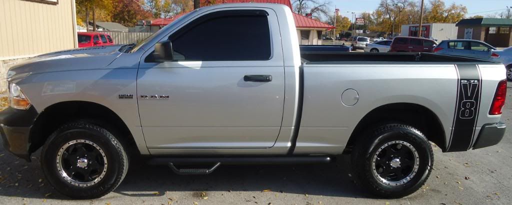

How deep can these trucks ford before water starts to do some damage?:4-dontknow: I wanting to know if water comes over the bottom of my doors will it leak into the truck and if not how far up the truck can water be before it goes in the air intake or cause electrical damage? You know just in case i get put in such a situation.:gy:

I don't have an answer to your question but just had to say, that is one of the nicest looking ST's I've seen, sweet truck man, like what you've done with it! :smileup:

^^^^ I'll second that, nice looking RAM. Somehow that V8 logo fits. :4-dontknow: Sorry can't answer your question, never had mine in water that deep.
