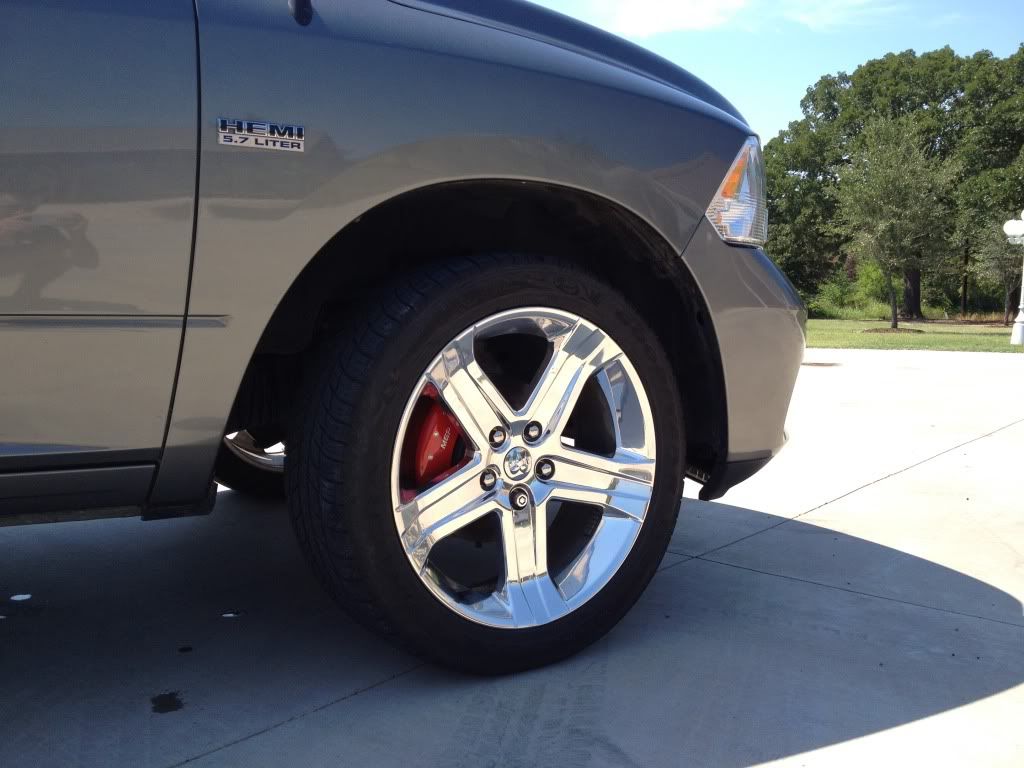

Hey guys, its been a while since I've been on the forums. I got a few updates! I installed MGP brake caliper covers because my painted calipers were chipping.

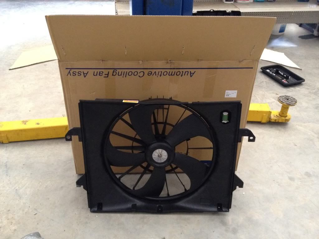

The UPS delivered my TYC electric fan (Mopar v6 knockoff) to replace my clutch fan.

Just a word of advice on the TYC v6 fan. Id locktite the bolts that hold the fan motor to the housing. I had one that just went on me. 2 of the 3 bolts backed out making the fan motor off-center causing the fan to rub the housing and inturn causing the motor to burn up (literally, smoking and all).
Otherwise, great fan as it worked VERY well (better than clutch fan + stock efan).

Installed the eFan this morning...worst mod install I've had so far, even worse than installing the ARH longtubes.
Gettting the stock clutch fan is nearly impossible. After spending nearly an hour, going to three different auto part stores to find a special tool which nobody had, breaking/bending several tools, cutting out the old fan shroud for more room, my dad and I finally decided it was time to weld our own tool.
Now with this tool and the old fan shroud out of the way, we were able to remove the clutch fan. The rest of this mod is quite easy. In fact, if my clutch fan had come off right away, this would have been a 10 minute mod. I got some Permatex Thread locker as another member on this forum suggested, and used it on the two bolts that hold the new fan in place.
I cut the nut from the clutch fan off and put it back on, I'm not sure if that was necessary...
I haven't been able to test the new fan due to my PCM being shipped off. Dave at B&G should receive it tomorrow, and then he is going to call me so I can give him a list of my mods so he can tune it accordingly.
Here's a fan comparison with the new TYC fan being on the left.
I found a helpful thread on how to do this fan swap in case any of you plan to do this in the future.
http://ramforumz.com/showthread.php?t=108220&highlight=fan+swap
