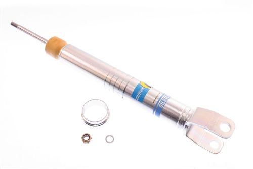

There are two different ways you can level the front of an 06+ Ram; Bilstein 5100 adjustable front struts or spacers.
Bilstein 5100 Adjustable Front Struts
The Bilstein 5100 adjustable front struts allow you to raise the front end of your truck by raising the lower spring seat on the strut assembly. There are 5 different height settings, 0 (stock), 0.7”, 1.4”, 2.1”, and 2.8”. By setting the lower spring seat at any of those heights you will gain that much front end lift on your truck.
Bilstein 5100 Product Brochure
There are a number of advantages of running Bilsteins over strut spacers:
• You will improve ride quality by installing the Bilstein shocks on your truck. I find they make the front end slightly stiffer but more controlled in doing so. There’s less bouncing which provides a smoother ride.
• The install is “cleaner” and provides fewer areas for things to come loose or break. Because it is still one strut assembly there are only 3 bolts on the top and one on the bottom unlike spacers where you have 6 bolts on top with weak point where the spacer meets the strut.
• The Bilsteins limit the amount of downward suspension travel which will not allow the control arms to overextend which is hard on CV shaft joints, ball joints, and tie-rod ends.
• The Bilsteins DO NOT limit the amount of upward travel giving you more articulation and flex and less chance of bottoming out.​
I would recommend Bilsteins to 95% of people who want to level their trucks. In my opinion (and many others) they are the best way to level 06+ Rams. They will provide you with the leveling you need in order to clear larger tires and improve the look of your ride plus they can be used with a lift down the road if you plan on going that route.
Bilstein Install
The install of Bilsteins is not much more complex than strut spacers. The disassembly of parts on your truck is exactly the same. The difference is what you do with the strut once you have it removed from the truck. The only difference with the Bilsteins is that you need a spring compressor in order to disassemble the stock strut and then assemble the Bilstein. You should be able to rent spring compressors from most local auto part stores.

Very nice thread has tons of useful information! If I may add when I took my struts apart to do the Bilsteins, a set of Craftsman Max Axess wrenches will be your best friend. You can put the socket down over the shaft on to the nut and use a combination wrench (on the factory strut) and the allen key (on the Bilstein) to hold the shaft from spinning while you loosen/tighten it!
This is just a pic I found online using both wrenches that come with the bigger max axess kit (a smaller cheaper kit is available in black for about $40). The top of the shaft with the hex end is exposed from the wrench so you can use a regular combination wrench or crescent wrench as that is the way I did it
5,878 Posts
yes! that's what I tell everyone. those were my life saver
