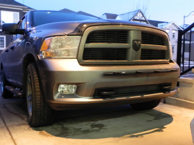

sorry guys, got these done last weekend, installed my tow hooks on the front, and got my N-fab light bar installed, lights are waiting for me to pick up at the border.... hehehehe I went BIG & bright on the lights hahahaha
sorry the girl is a bit dirty, she was washed yesterday

Look forward to seeing the lights installed. How does the lightbar install.
1,300 Posts
Good look. How was the cuttin out for the hook install was it hard and does it come out well? Just curious. I have thought about it myself, they dont come on the Express even the 4wd.
355 Posts
Looks good! Which brand and size of lights are you going to add? I'm going to be adding 3 up front on my front end replacement and am torn on the size.
738 Posts
Discussion Starter · #5 ·
the front facsia cover does have to come off and 2 holes drilled where the licence plate bracket and then it bolts on, took me 20mins to install. It was freakin easy.
I took the plastic panel off and used a dremel and cutting wheel, made quick work of it.
going with 4 x 6" Soltek Prerunner HID spotlights

Cant wait to see updated pics, you are going to be a rolling sun!:str::str:
Even the big horns dont come with them, I believe they are an option on all trim levels?

hey guys the hooks were a 5min install, they were soooooo easy to do, just loosen 2 nuts on both sides and install the nuts and the supplied bolt, only tedious part was the trimming on the plastic.
1,300 Posts
Thanks for all the info. This is gonna be a must do for me around 1st of April since we will be headed into our remote camp on the pond on our Family Spring run around 2nd week of April. Good to know its an easy do.
738 Posts
Discussion Starter · #15 ·
install took 20mins, just the 2 plastic screws on both side of teh fender well, 2 metal screws in that meet the bumper to the fender, the 4 bolts along the underside of the black valance, and remove the grill, off she comes, drill 2 holes on where the licence plate bracket goes and insert the bolts, tighten amd reinstall the bumper cover.
