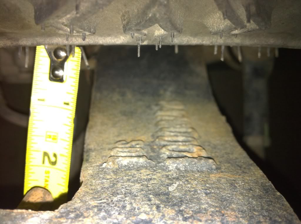

2 of the guys I know running 37x13.50s rub and they have 6" lifts with maxed out bilstiens. One of the tires is toyo mt. The other is mud graps. Both of them also have 20x10 wth 4.5" bs. The mud graps are also 1/8" from hitting the knuckle. With my setup I'm a solid 2" from the knuckle.
