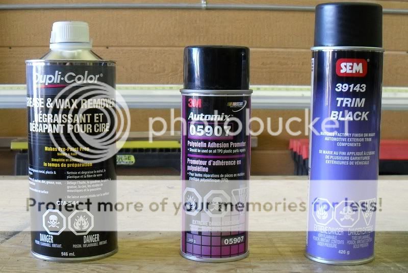

Went and got some 'Tried & Proven' stuff -

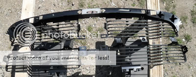

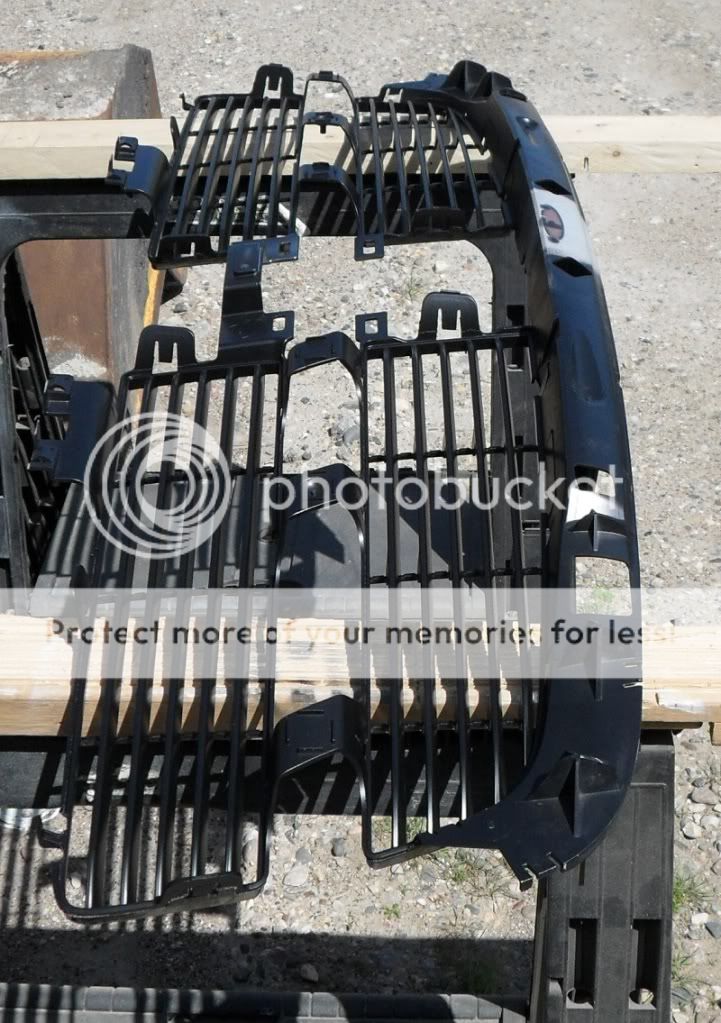

After you remove the grille assembly from the truck, your left with this -

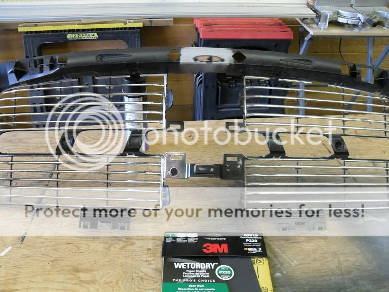

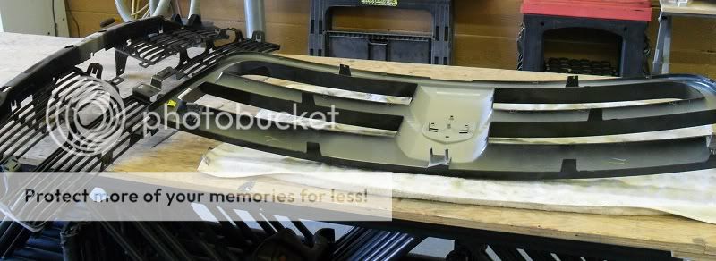

Here is the 'painted' grille insert after a few minutes at the car wash -

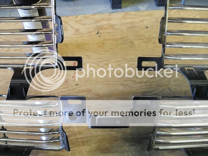

Although I now have the tried and proven stuff, decided to use the chromed area in the center as a test area; 3 sections
Left - no sanding + adhesion promoter
Center - Sanded with 320grit + adhesion promoter
Right - Red scotch pad scuffing + adhesion promoter
Test 1 - Car wash (this completely removed the left side)
Test 2 - Screw driver scratch (both remaining sections scratched equally well)
Test 3 - Finger nail scratch (Center stood up, right did not)
Test 4 - Scotch pad (Center stood up, right did not)
Test 5 - 320 grit sand paper (Actually took some work to sand through the center :smileup:)
Tests confirmed that agressive sanding was the way to go, so 320 grit sand paper it is! (All the professional painters on the forum are too stunned to even laugh :158:)

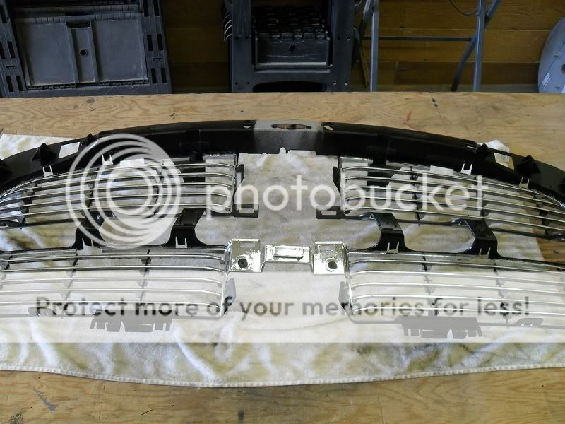

Here you can see the results. The right side of the pic is sanded, the left is yet to be done.
Finished the sanding, cleaned and cleaned and re-cleaned with Grease & Wax remover, followed by paint thinner, let dry for 15 minutes and applied 5 light coats of SEM trim paint and set it in the sun to bake. Heres a couple pix showing the paint drying ;) -

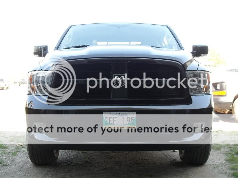

After about 5 hours baking in the sun, I introduced the insert to the grille surrond -

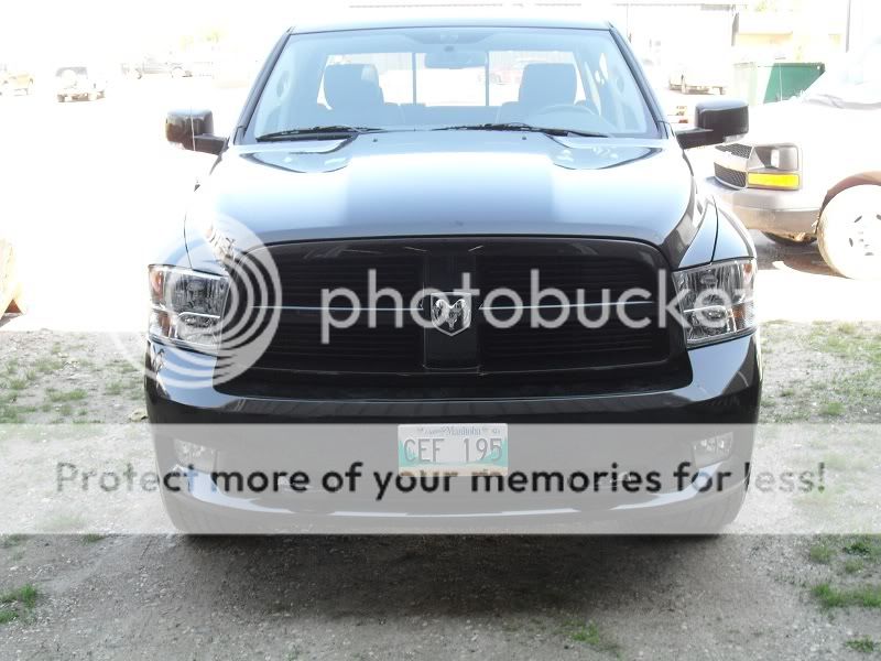

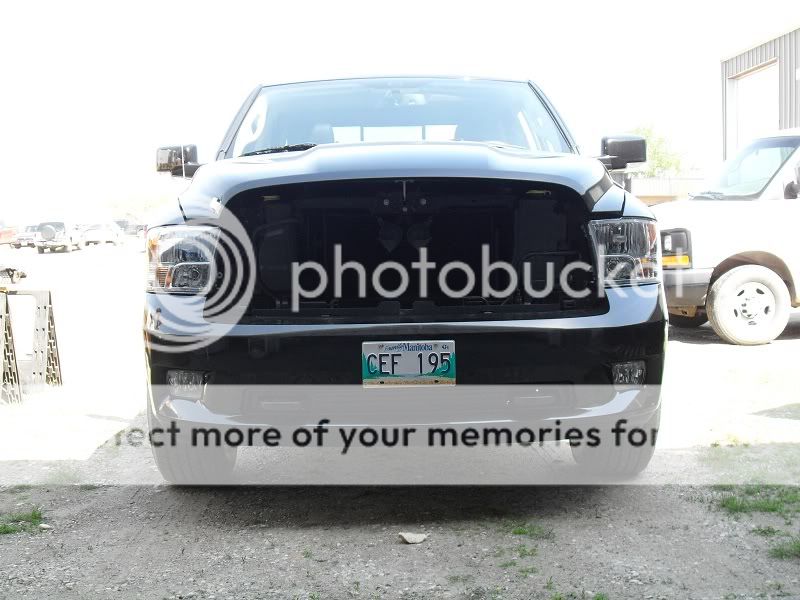

And since the surrond was accepting of the newly painted insert, I assembled it for the 63rd time (or there abouts) and ended up with this -
This was completed on the 3rd of June 2011, and so far so good. Been to a high pressure car wash a couple of times, and the paint is sticking. It does have a couple of very tiny chips from stones, etc. and I will likely repaint it and finish with 'Satin' clear coat, that I didn't even know existed, until a few days ago.
