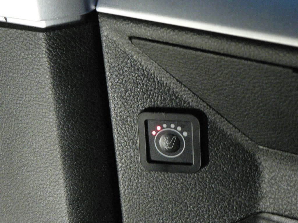

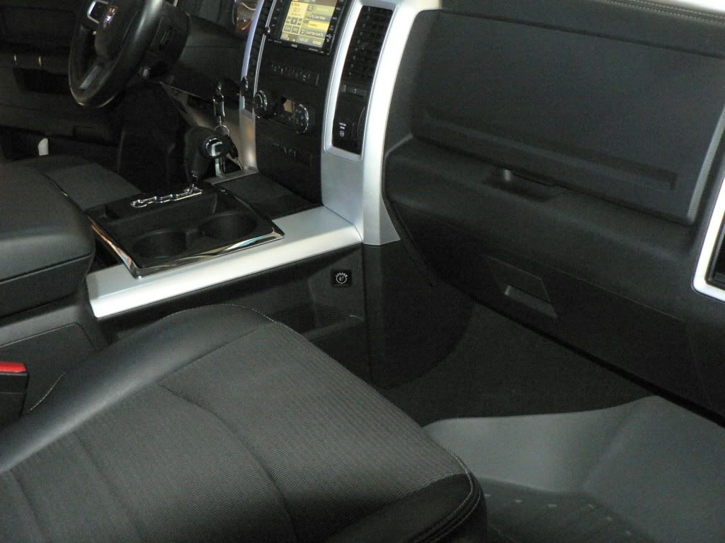

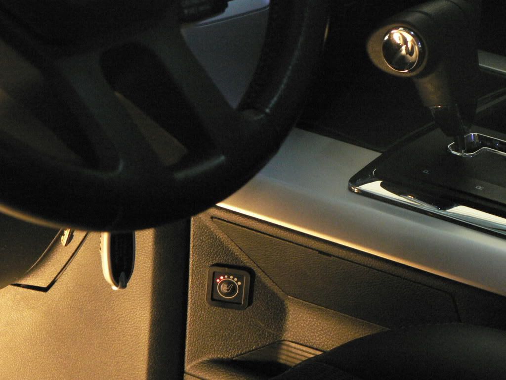

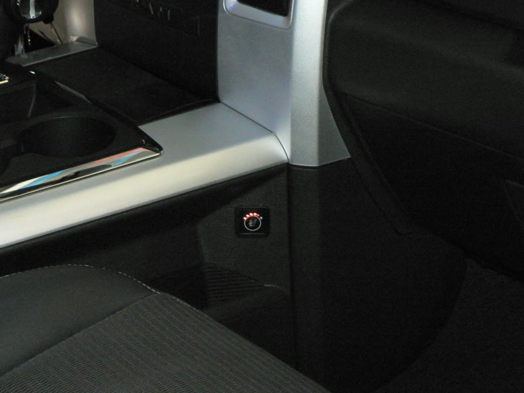

Thanks for the points. Ya, I am quite pleased with where I mounted the switches. Out of sight however easy to press and when the LEDs are on you can glance down and see them from the driving position.Nice job! Really like where you installed the switches! :rep:![]()
Thanks, they heat up really good as well.Sweet looking. was thinking about doing that to mine one day. Nice job looks good.
I see no reason why they would not work on a 2nd gen, you just need to figure out how to get the heating pads installed since the seats are different. There is only a single connection to the vehicles electrical and it's made to the 12volt keyed recepticle in the centre console. It's plug and play on the 3rd and 4th gens so it may just plug in on yours as well.thats awesome, think thats compadable on a 2nd gen?
Thanks Brad for the rep points, I only need three more to hit the 1000 so come on guys push me over the top LOL.Nicely done Randy! :smileup:

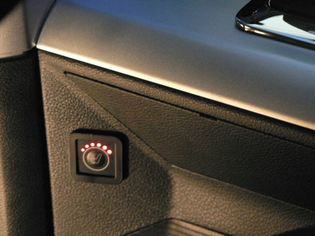

I noticed there are 6 LEDs. Does this kit offer 6 different heat settings?
Thanks. In theory you could probably do it however you would need to build an interface box. The mechanical properties of the switches are different. I did research it but in the end I decided to somewhat hide the switches and get my heated seats installed, it's getting colder here every day,Nice job!! Are those switches too big for the factory location?? Could a person buy the factory switches and hook them up?

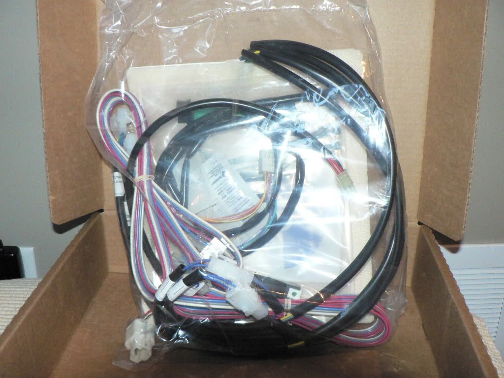

^^^ Might be $250 down there it was $300 here but everything is more expensive in Canada. No worries about the cloth, this kit works on leather or cloth. I have the cloth seats and it installed with no problems. Really works good and on those cold mornings. :smileup:looks good,this the 250 dollar kit right..i want this kit ,but i have cloth seats think i can still use it
Thanks. BTW it is the same kit for the 08's. It actually can be installed on several different vehicles as well, not just the RAM.That looks great nicely done. Will look at that for my 08
Thanks for the information Randy. Unfortunately I don't have the center console like the newer RAMS your positioning of the switches is great I thinkThanks. BTW it is the same kit for the 08's. It actually can be installed on several different vehicles as well, not just the RAM.
