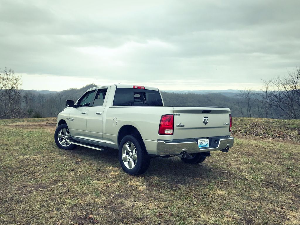

Here is my bone stock 2014 RAM 1500 Big Horn Quad Cab. This truck is going to have to wear a bunch of hats for me, but I hope to add a few mods to make it more suited to all I am going to ask of it. I plan on leveling it so I can add 275/65s on the stock 20s. I'll probably add a tool box, some basic recovery gear, and maybe CB/2M Ham set up. This will hopefully be a work/family vehicle through the week and a mild overlander for some weekend fun. I'm sure I'll come up with some other ideas as I check out the forms. Thanks for stopping by to check out my rig.
