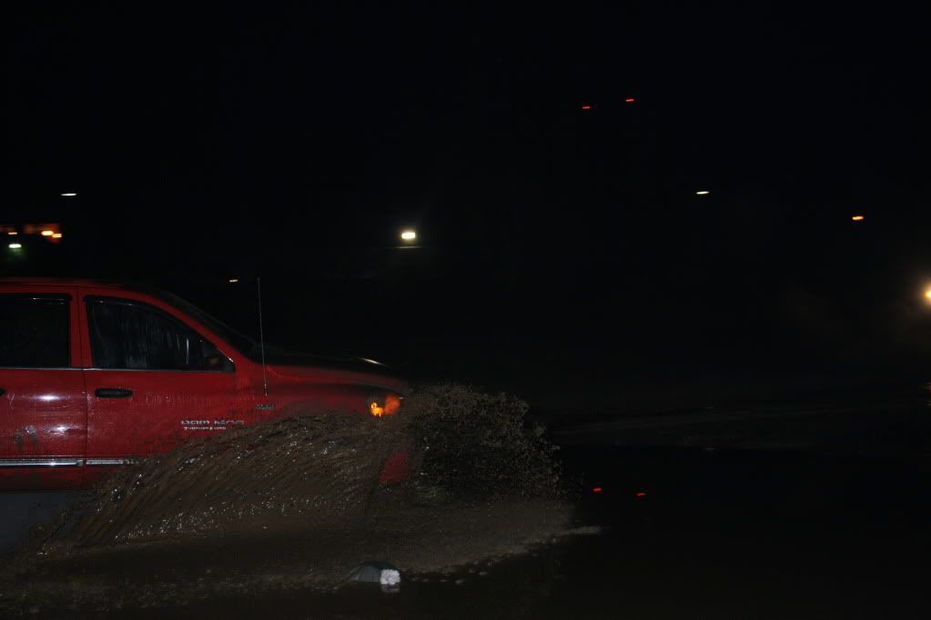

Me and my friend muddin a lil. im only 16 so, not too many mods yet. im the red truck. When i got home i had some major charging system problems :(. i think its a fusible link.

Based on the photos, it looks like you drove through some of the mud kinda fast, which likely sprayed mud up on/in the alternator. This can often be remedied with a good wash under the hood. Good Luck :)

If you replaced the alternator, then that rules out dirt inside it. LOL

Great pics! Hope you find the problem soon. I think Brad has you on the right track.

Very cool pics man, definitely looks like y'all had fun! Sure hope you get that electrical problem figured out soon!

it looks like you are having tire pressure issues. your pic of the front looks low. just my opinion though
very cool picks, watch out with the extra fog lights you can get a ticket driving with them on
yes, the last picture the tire was low because it blew up :( they were low when i was there because i had just goten off the beach
Looks like fun.
