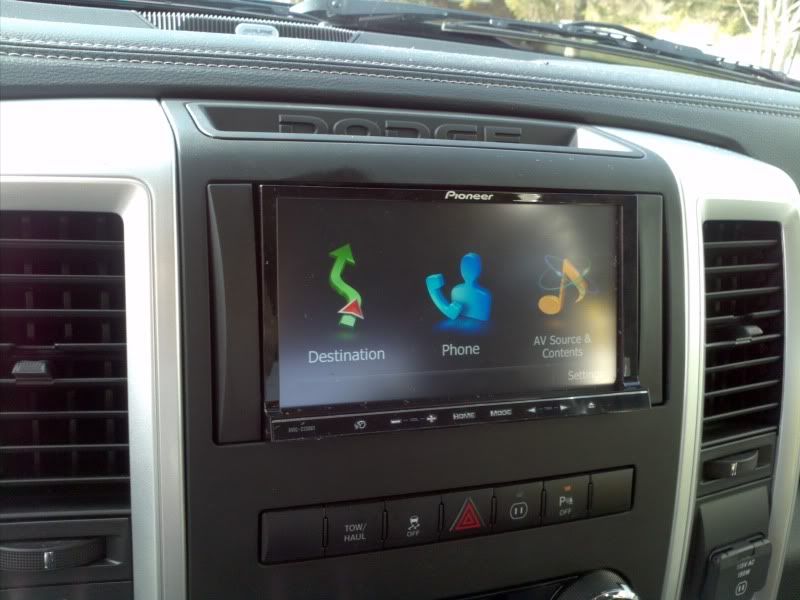

This should do it. I bought mine at Sonic Electronics. They should be here tomorrow! Check their price on that deck too. They have some awesome pricing.
Hey I pm'd you too. You do NOT need the Can2 as the website / instructions suggest. They are wrong. I got mine installed today and it works great with just the C2R-CHY4 and the SWI-RC. Apparently the CHY4 has the CAN2 built in now. Even the application specific instructions are wrong! Just plug the CHY4 into the RC and plug the jack on the RC into your head unit. Sorry for the confusion.
Great. I'm glad you didn't buy it. I have to ship mine back.
