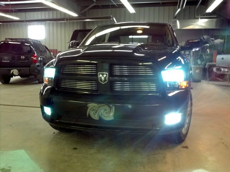

I finally made the leap and installed some hid low / fogs in my truck. I got them from a local guy off Kijiji. He bought them from HIDextra.com. The bulbs are 6000k. The install was real easy / plug and play. I used capacitor harnesses on the low beams and there is no error codes. The tpms light comes on for about 3 seconds when you first turn the lights on but then it goes out and there is no problem or flicker. I will order the highs from them soon. The DRLs suck as they are yellow. Up here in Canada we have to run them though.

Ugh I spoke too soon. The tire light is coming on sometimes now. I'll have to try and relocate the ballasts for the fogs.

Is the receiver for the TPMS near the fog lights? Where did you mount the ballasts that makes you think it is causing the problem?

Dont bother no matter where you put them the tps light will come on for a few secs its just what the 4th gen does nothing to be alarmed about it should only stay on for a few seconds

I dont know where the receiver for the tpms is. I'll have to try and shield them or something. I wouldnt worry about the light only coming on for a few secs but with the fogs on the EVIC displays a problem and the light flashes. That along with the warning chime periodically drives me nuts.

Humm did you put the wiring harness on the headlights with the elimanator on it that might be the problem i know the fogs usally dont cause anything to come on but if you just did the headlights with no harness that might be the problem

Thanks. I did do the headlight harness. I know its the fogs as the issue only happens when the fogs are on. Never with just the headlights.
