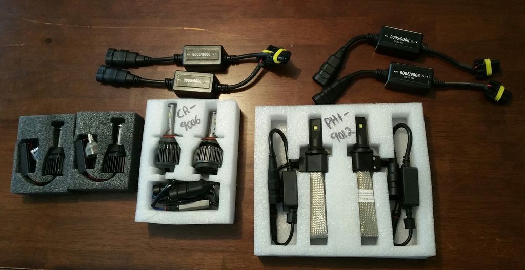

Just as the postal service said, I had a box waiting for me at the door. I quickly unwrapped it to find all of my LED's very well organized and well padded in the box. A quick inspection of everything showed me that all looked good. The wiring felt like quality wiring and not the cheap R/C toy car type. The materials had some weight to it that lead to the belief that it will withstand vibrations and other factors once mounted on the truck. Here is a photo of what was in the box. I had LED Reverse lights, 9012 Phillips LED for the headlights and 9006 CREE MK-R LED bulbs for the fogs:

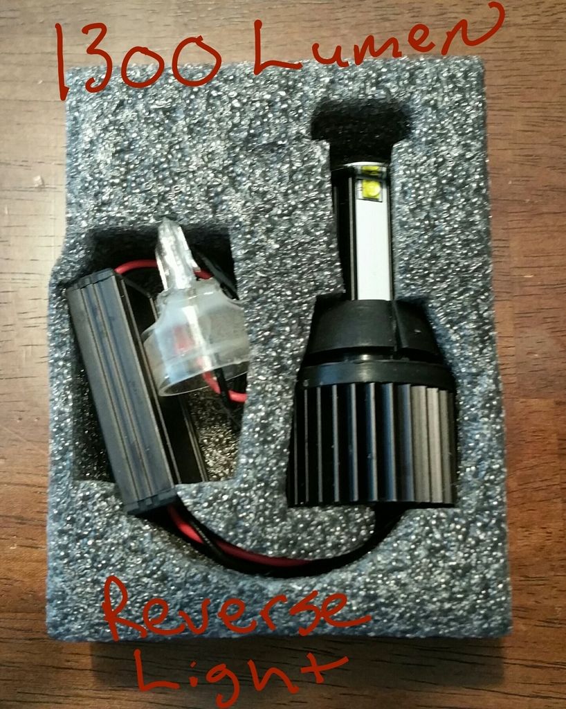

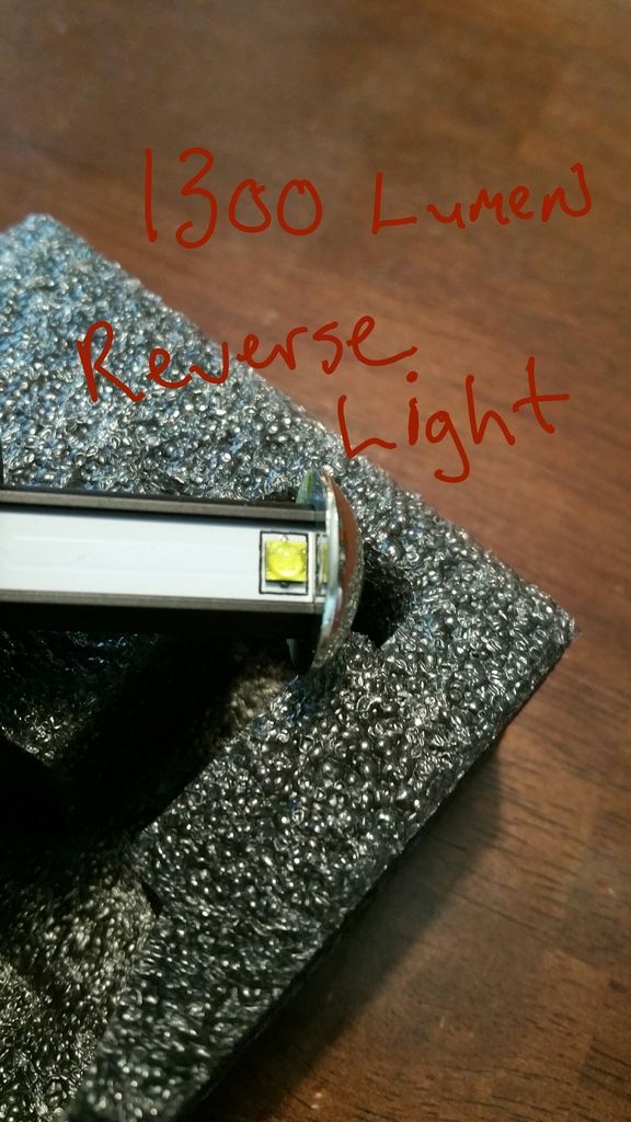

Here are a few of the 1300 lumen reverse lights. The bulbs have two LED's and one will be positioned so that the LED faces the plastic tail light housing and the other will face the reflector inside the housing:
This image has been resized. Click this bar to view the full image. The original image is sized 818x1024.

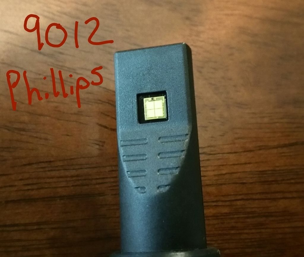

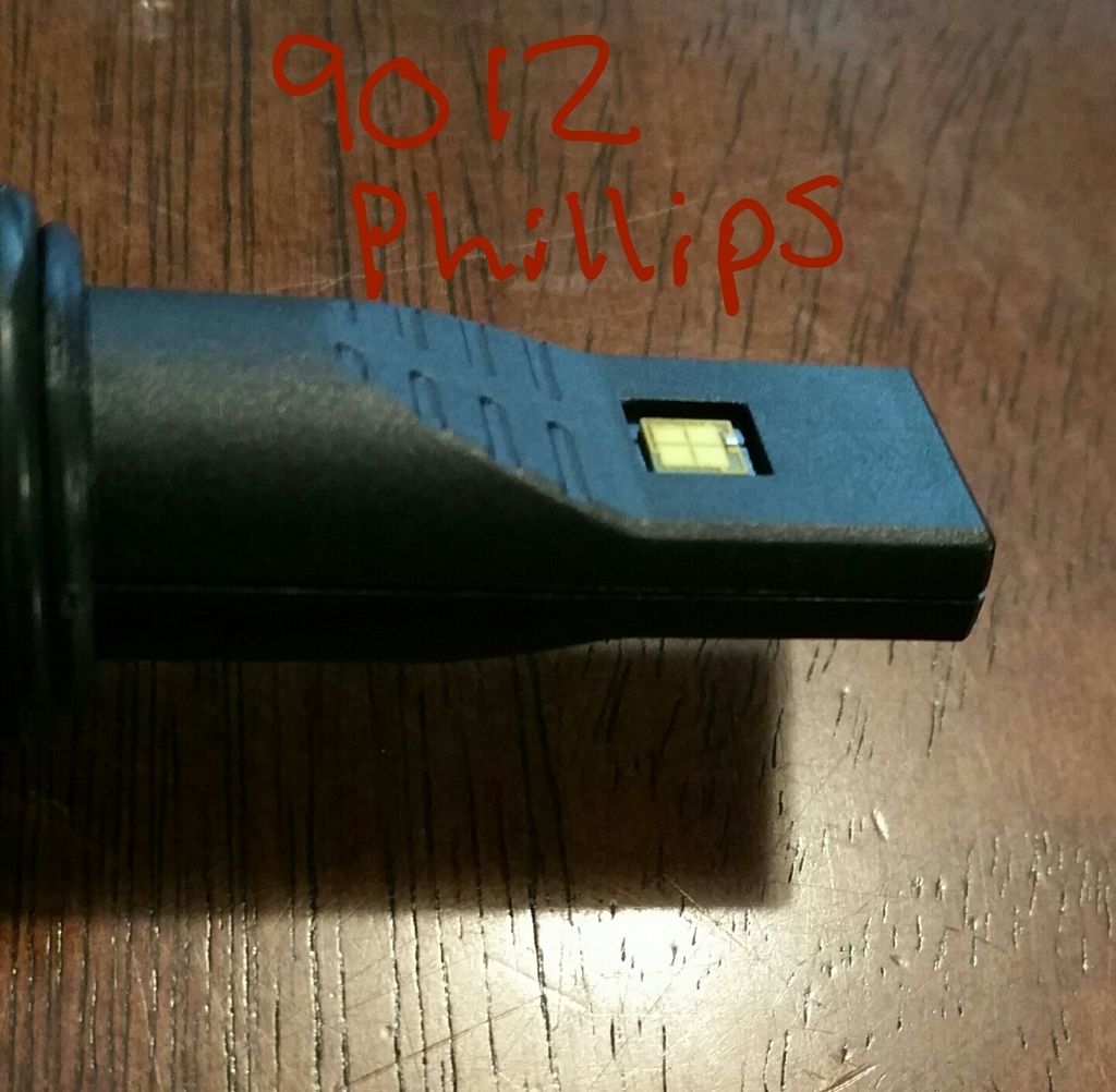

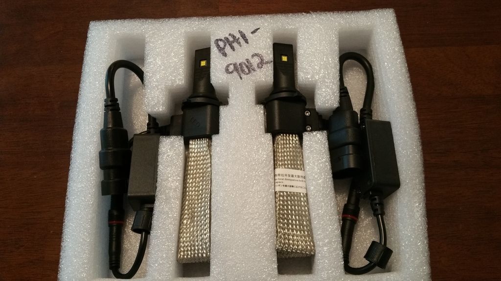

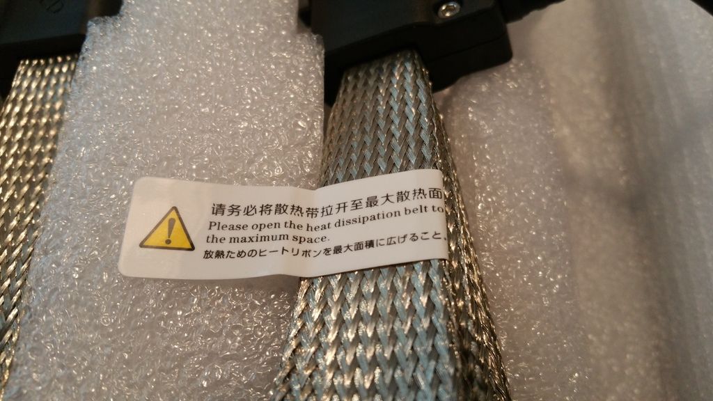

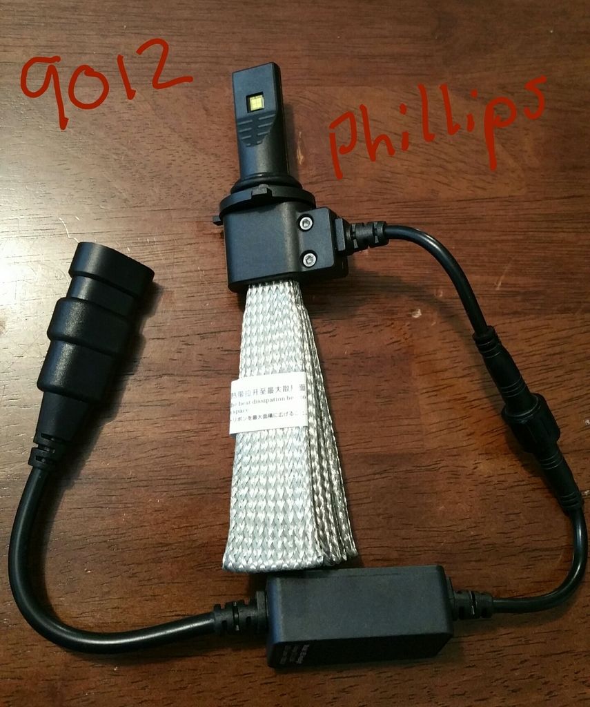

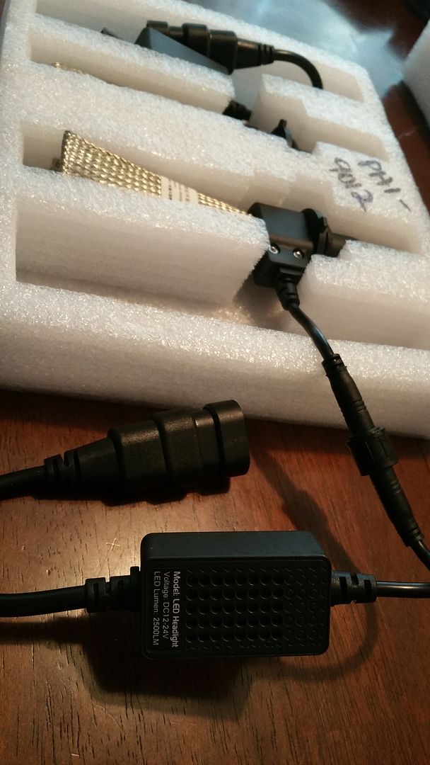

Here are the 9012 Phillips LED's that are rated at 2500 lumens each. Each bulb has two LED's and a metal braid for cooling. There are (4) braids and in order to close up the projector housing you will have to place two braids on one side of the housing and two on the other side. Once I get around to the install, I'll take a few photos. Notice the LED has (4) clusters on it and the LED itself is flat with no rounded "cover" around it.

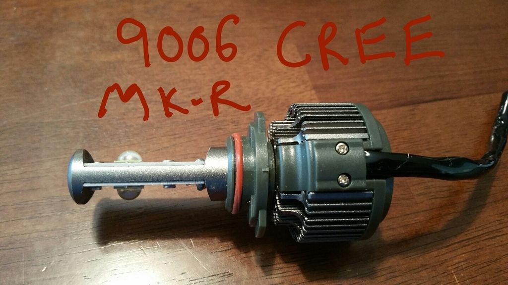

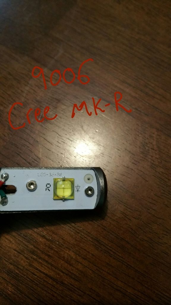

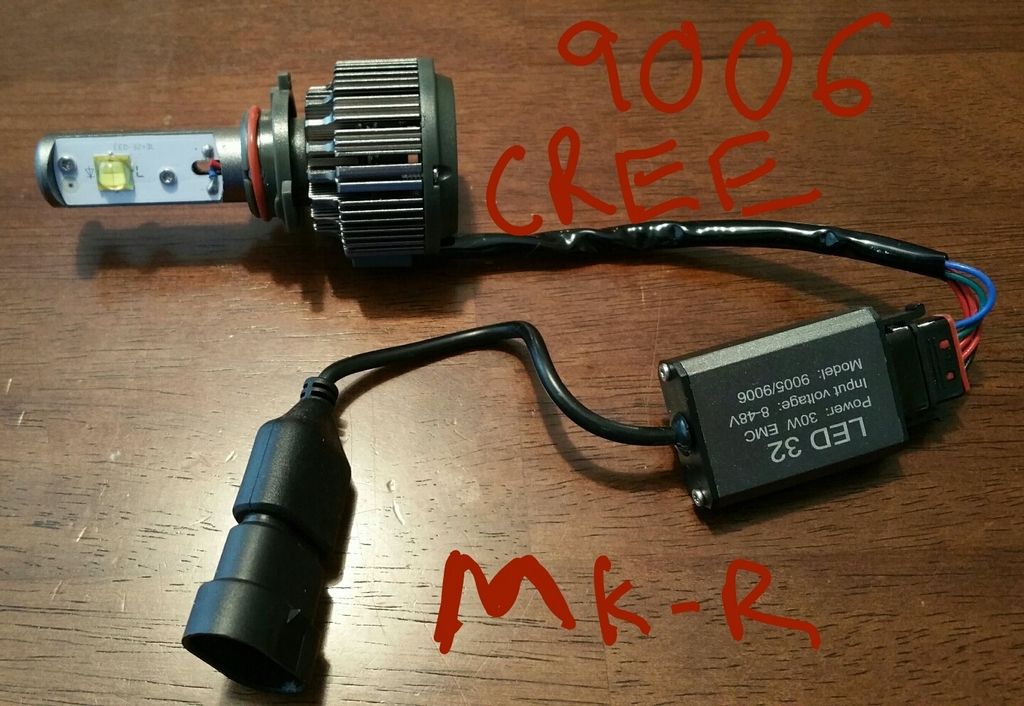

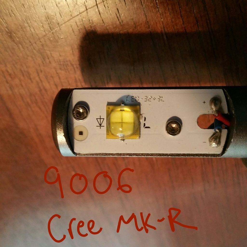

Lastly is the 9006 CREE MK-R LED. These push out 3500 lumen each and they have a heat sink with fan on the backside of the LED to help keep it cool and disperse the heat. These will not fit into the headlight housing of the projectors on our Rams because the heat sink does not fit behind the dust cover. Notice that these bulbs have two LED's on them and they are labeled "L" and "R". I'm not sure if it matters how they are mounted, however I will pay close attention when it comes time to put them in and make sure the left LED is in fact facing left. These also have a cluster of (4) on the LED itself, however notice the LED is very large and round unlike the Phillips LED.

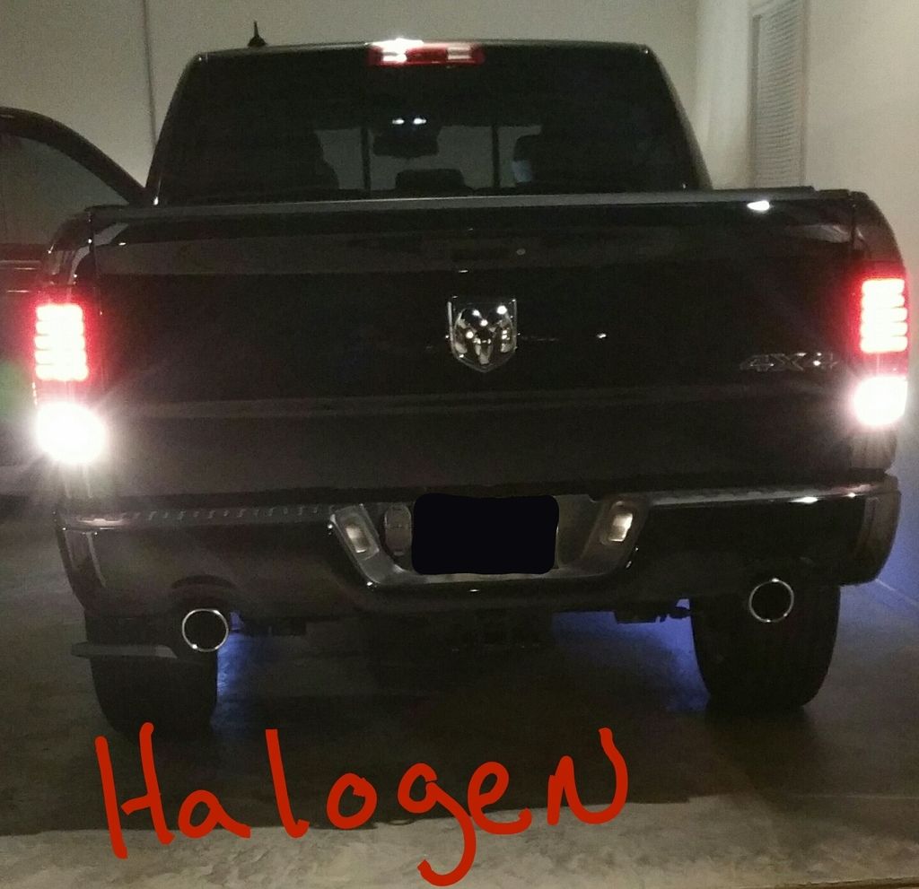

Discussion Starter · #5 ·

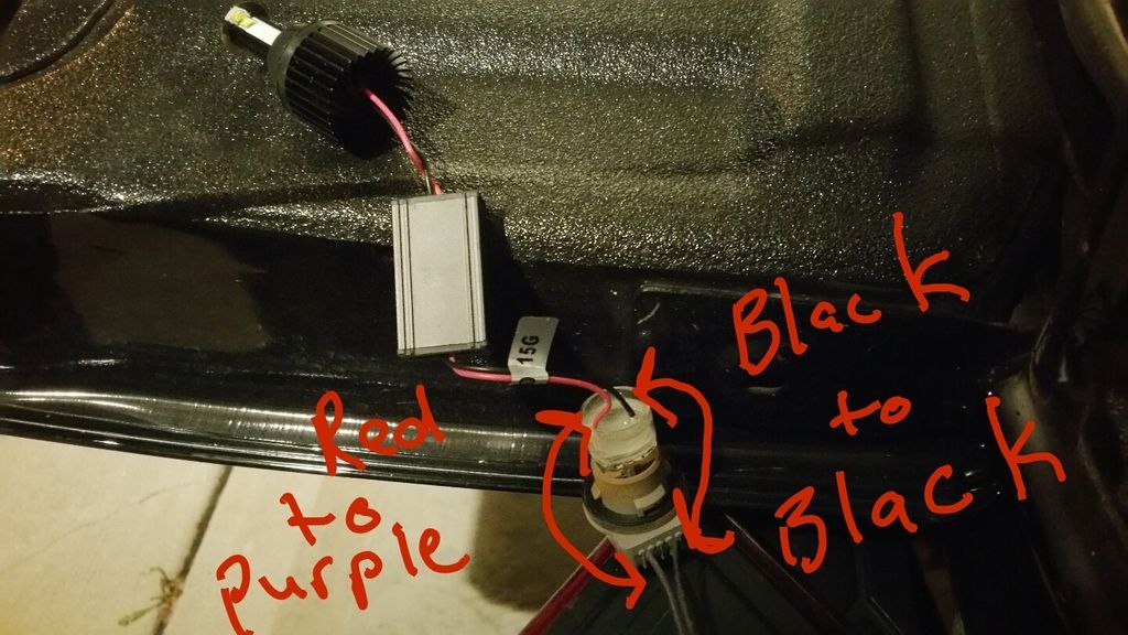

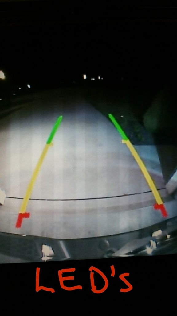

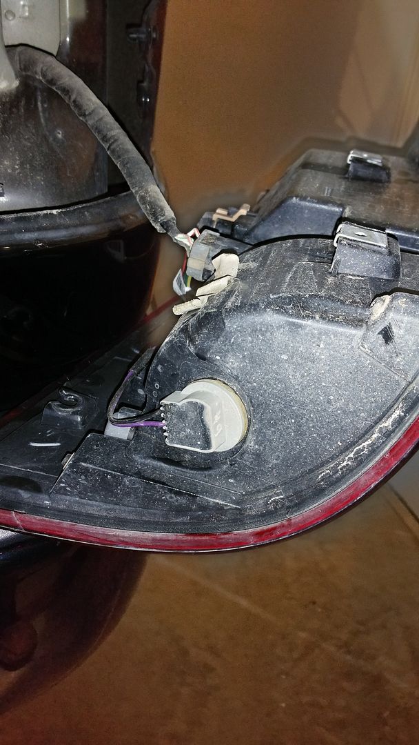

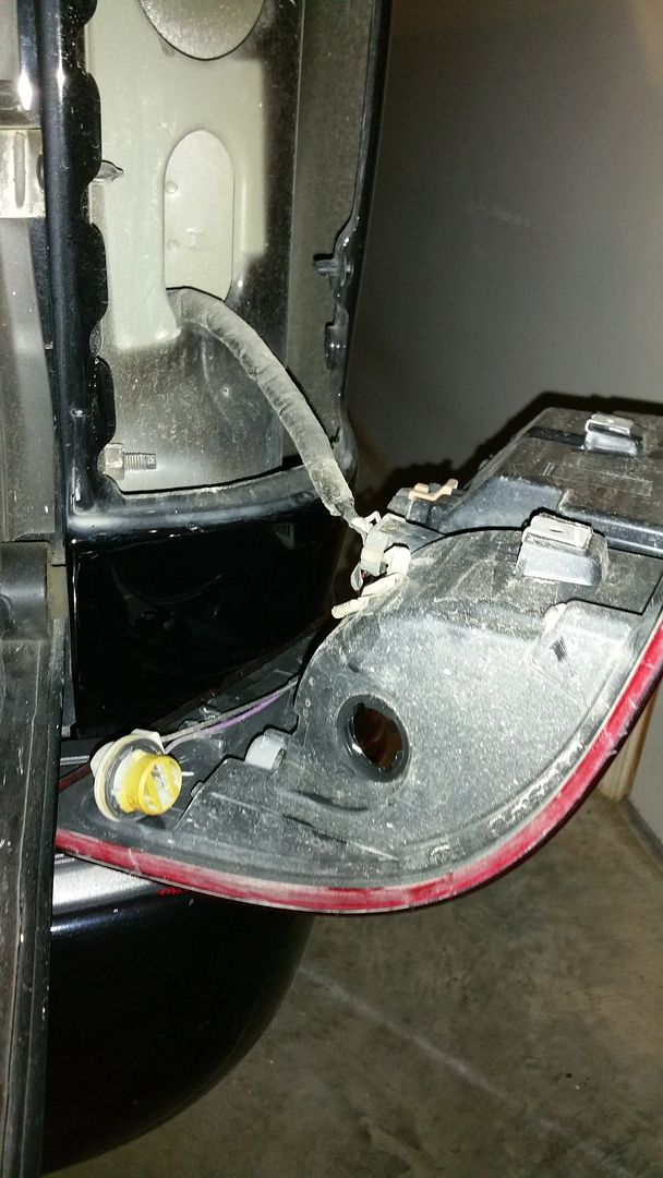

I threw the reverse lights in tonight since they are easy and quick to install. All you'll need to do is take out both torx head screws that hold the tail light in place and remove the halogen bulb from the bottom of the housing. You'll notice that the reverse light was made so that it connects the same way the halogen bulb did. Be mindful to make sure the black OEM wire lines up with the black wire on the LED bulb and the Purple OEM wire lines up with the Red wire on the LED bulb. There is a rubber grommet that holds the LED in place so that you can position the bulb by just turning the LED housing. You'll position it so that one LED faces the back of the reflective housing and the other LED faces out the rear of the taillight directly at you.

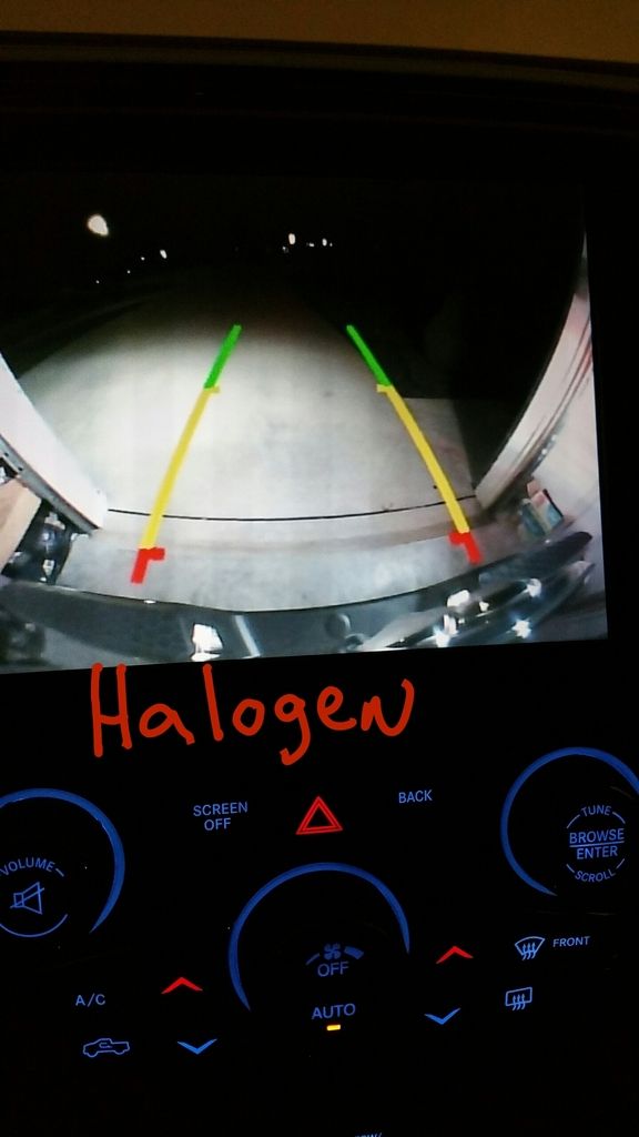

As you can see in the photos, the light is much whiter and crisp. I believe the LED bulbs are a little brighter, however it wasn't a slam dunk in my opinion. I'll let you all decide for yourselves from the photos. I apologize for the photos on my Uconnect screen. It's never easy to take a picture of a picture.

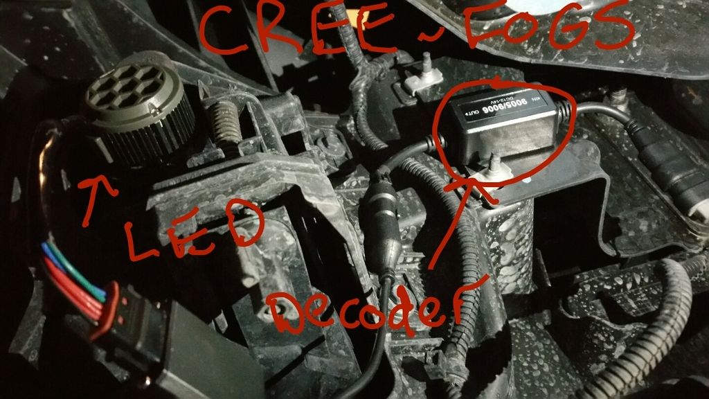

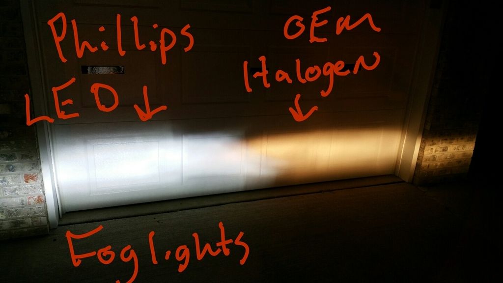

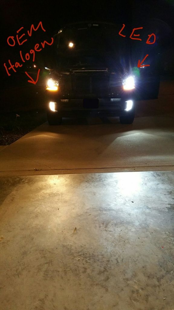

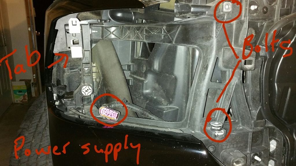

Ok ladies and gentlemen... I hope you throw some rep points my way, I'm burning the midnight oil to make sure I got some good photos for you. Installation wasn't horrible and it doesn't add any steps to the process if you were just changing out bulbs. Note, you will have to get into the inner fender through the wheel wells in order to take the headlights out. You'll first start by removing the grill off the truck and then it's as easy as removing two bolts, releasing the plastic tab through the fender well and unplugging the power supply.
This image has been resized. Click this bar to view the full image. The original image is sized 1024x576.

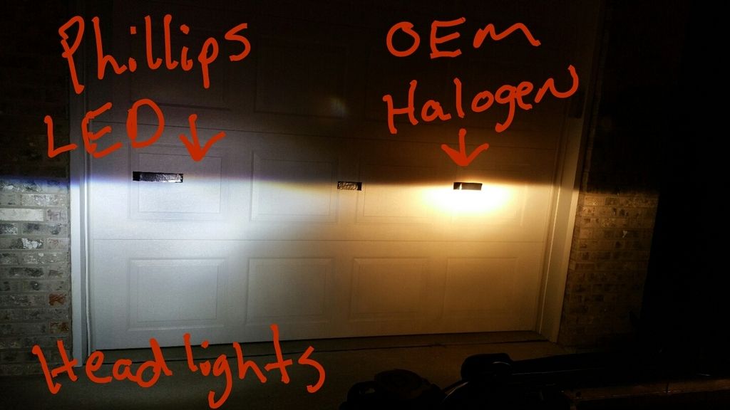

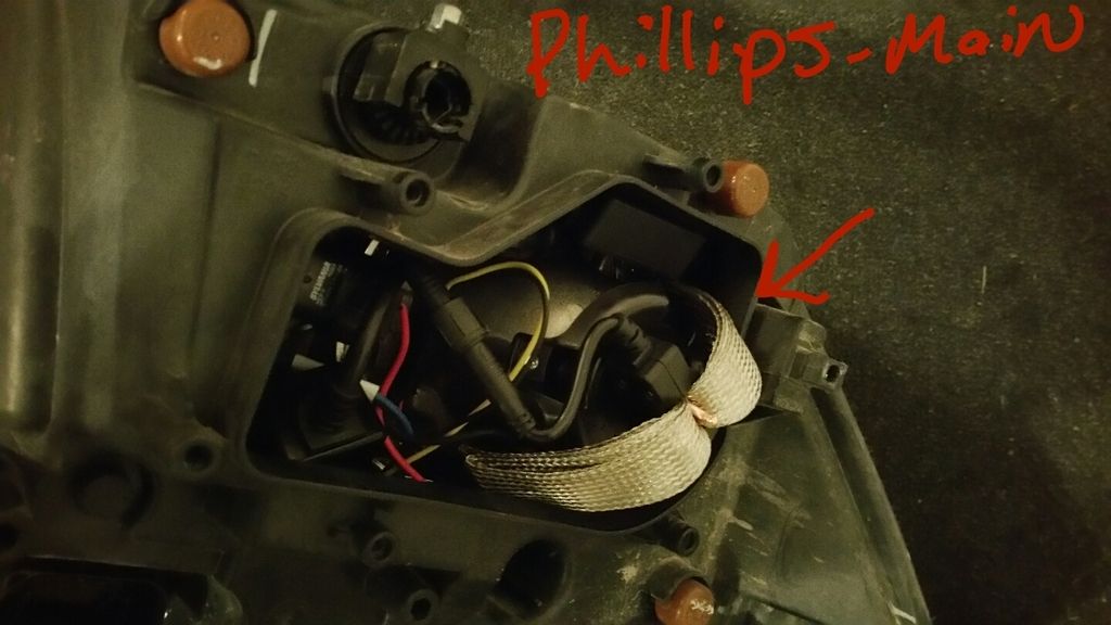

Install of the Phillips bulb in the headlight is very easy. Separate the cooling braids and place 2 on one side and 2 on the other. Everything else fits nice and neat into the housing and the dust cap closes tight with no issues. **Note, I did take photos of the CREE LED's in the headlights, however the dust cap had to remain off since the heat sink does not fit behind the dust cap**

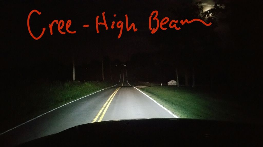

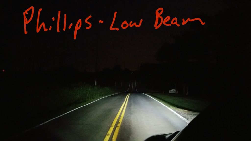

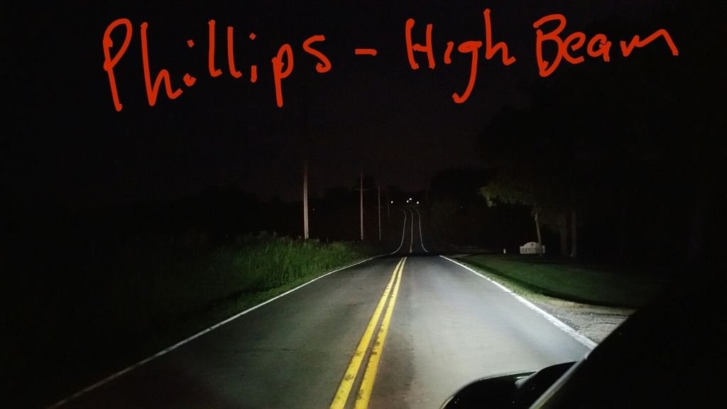

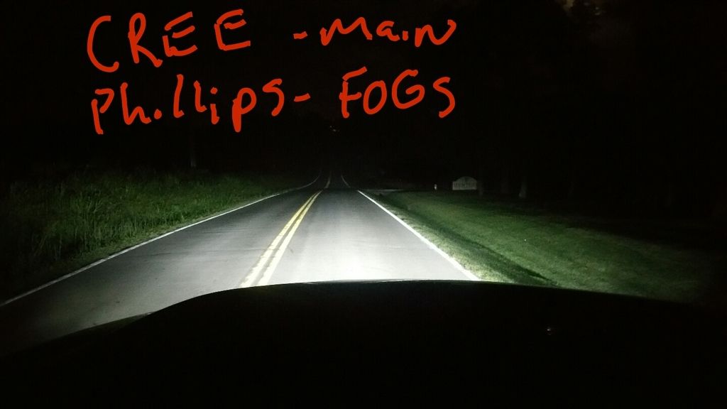

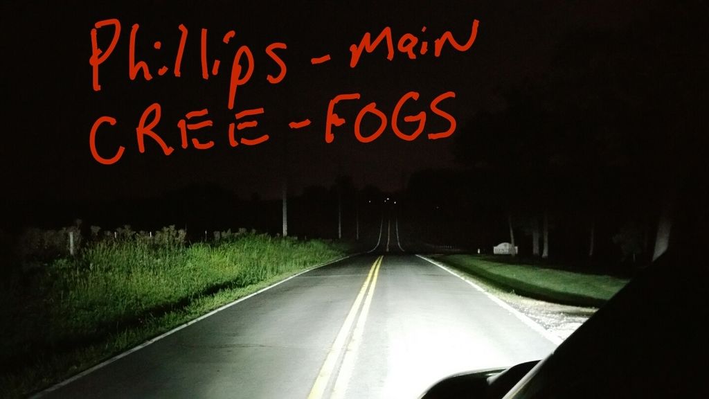

I'll let the photos do the talking for me, however I will say my personal preference is having the Phillips 9012 bulbs in the headlights and the Cree MK-R's in the fogs. The light output is MUCH better in this configuration and it seems like the Cree bulbs just push the fogs to do as they are designed- to push light low and wide. Though the Cree bulbs were brighter than the Phillips in the headlight housing, it wasn't enough to convince me. The color is crisp, brilliant and clear. It's a night and day difference from OEM. I had no error codes on my 2014 when I installed the lights without decoders, however I have thrown them on to complete the installation and avoid crawling under/through my truck again.

Also, you have to really look at the photo I provided of the CREE bulb in the fog light housing. That bulb is designed to "shine" (pun intended) in the reflective style housing, like in the fogs or the quad light set up. They work well in projectors, however the beam is just phenomenal in the fogs. Even with an FX-R set up, I believe the CREE bulbs are so bright and crisp that you won't notice any difference in front of the truck. My guess is you would see a beam that might cast light a little wider, possibly a little farther and you would find a much more crisp/defined cut off at the end of the low beam on an FX-R modification vs. the stock projector.
