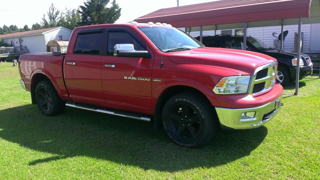

Pretty sure they are the fake chrome plated 20inch stock rims and then the chrome emblems. I want to plasti dip them black but I've heard not to plasti dip chrome. Will I damage the chrome? will it not remove correctly? I want to be able to remove the plasti dip later on without damage. Thanks,
