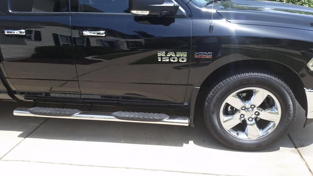

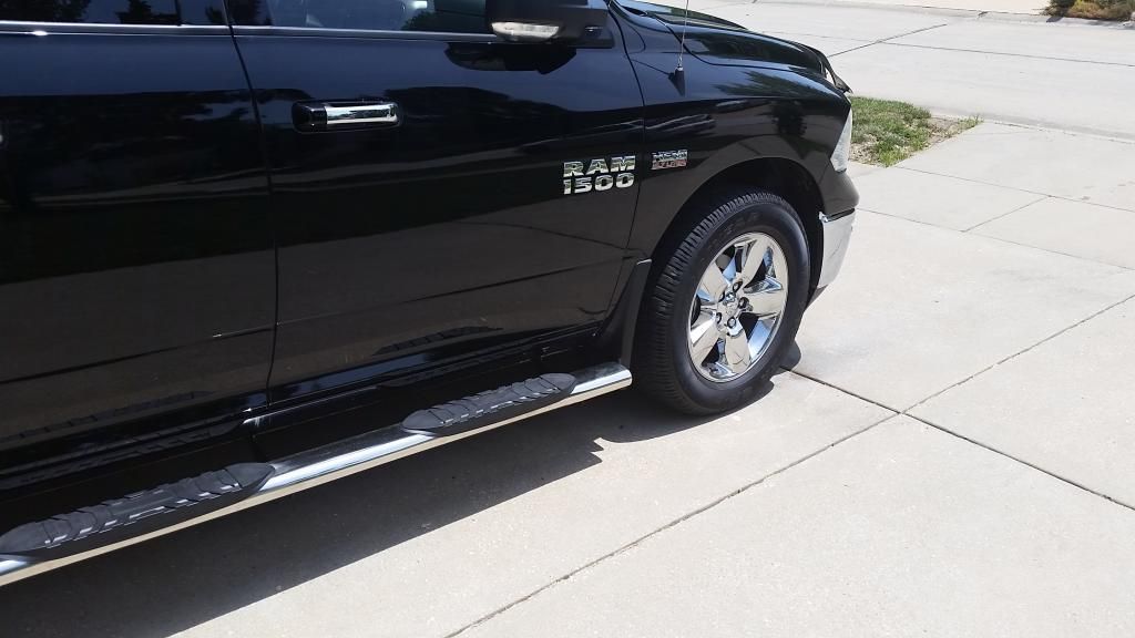

I just installed the ram mud flaps with my 5in bars. I had to make a new hole for the bottom of the mud flap. That pulled it in where it needed to be.it still touched the Nerf bar but Fit flush on the fender.

here is a pic. mopar said the flaps do not fit with nerf bars.I tried it anyway since I did not have the factory bars.I have the steelcraft 5in.I just had to twist the bottom of the flap and drill a new hole in the bottom.i really wanted these on the truck, I had them on the last 3 new trucks I had and they protected the paint. ( can not get pic to load )

Looks tight, but I like the Ram Mud Flaps. I have them on the rear, but put Husky ones on the front. The Husky touch, just barely, but they are also a different style. I'm trying to decide if I keep them or get the Ram front and slot the step rails to shift them backwards.
