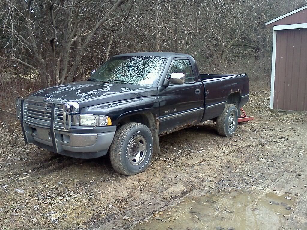

Well dont really have any updates at the moment. My grandpa bought it back off of us and its been sitting in his yard for a while who knows if he'll ever get to it he's finishing up the 4 year restoration on his 49 dodge truck this month so it might be a while until he's ready for a new project. I hate that i cant find a donor truck to put the engine or something in for less than a running one prices are crazy on those rams around here compared to same year fords and chevy's
Here it is as it sits now... just rusting away more everyday
